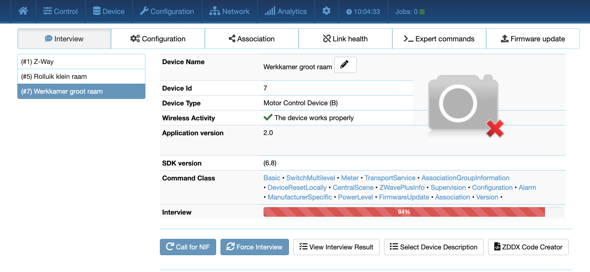

I'm currently switching from v2.3.8 (Raspberry 2, Jessie) to v3.2.2 (Raspberry 4, Bullseye).
Both systems are up and running.
I did move two roller shutter devices from the old to the new platform.
On the new platform the up, down and percentage do work fine.
But the "stop" button does not work.
I did try to re-include the devices with "Secure" and "Unsecure".
The problem remains.
Below I added a part of the z-way-server.log.
It says
"Job is already marked as waiting for reply, Supervision overrides it - check encapsulated packet not to be a Get"
I am not sure what this means.
Somebody any idea ?
Regards, sek.

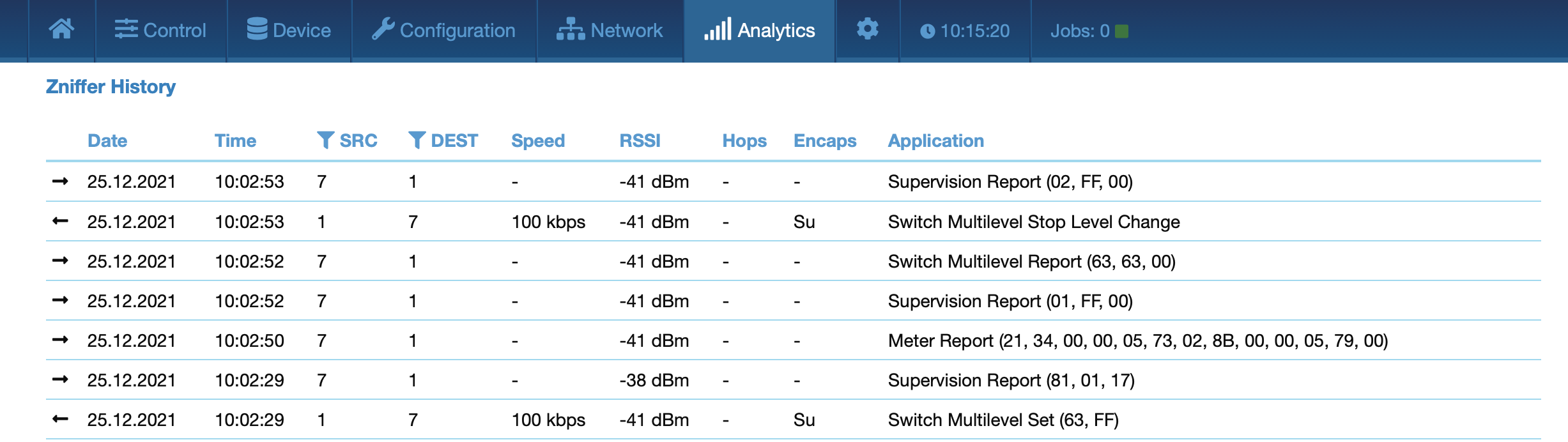

The log also shows the following:
[2021-12-23 14:57:09.831] [W] [zway] failure callback 0xb1cfd9f8
Your log does not show what function was associated with the callback, but the callback failure could be part of the problem.
As a suggestion, unless you absolutely need encryption, why don't you force an unsecure inclusion? That should provide similar log results to the v2.3.8 log file.
Also, you can use the Expert UI to better understand communication issues with the device by looking at Network->Timing Info and Analytics->Packets info. Ideally, packet communication should be fast (timing < 10) and efficient (100% delivered without rerouting).

1. Timings
I have looked into the timings. I do not see any problems. All within 3 ms.
2. Failure
The failure in the beginning is unclear to me.
As you can see beneath there is no activity in the minute before the "up" button has been pushed.
3. Channel 3 ?
I do not understand the noise check of the channels.
There are 3 to check but only 2 active ?
The logs shows: "Ch#3: not available"
(I use a razberry on top of my raspberry)
Is this a problem ?
4. "stop" delivered after "up" ?
Looking at the log the "stop" is delivered after the "up" has been completed.
The "Supervision" sets a delay of 23 sec.
I think this is the problem,
How to override ?

I did an insecure including.
To have a more clean log I changed the noise check from every 30 sec to 5 min.
So I have a part of the log beneath.
1. Timings
2. Failure
3. Channel 3 ?
Is this a problem ?
How to override ?

[2021-12-25 09:56:36.490] [D] [zway] SETDATA devices.7.instances.0.commandClasses.108.data.interviewDone = False
The results is the same, the "stop" waits for the command to finish:
[2021-12-25 10:02:29.447] [ I ] [zway] Node 7:0 CC Supervision: Setter packet was accepted for execution, but will take 23 seconds: SwitchMultilevel Set
[2021-12-25 10:02:29.447] [D] [zway] Delaying request job (SwitchMultilevel Set to node 7) by 23 seconds
The Expert UI says the interview is not fully done.
See attachement.
The "Supervision" is (still ?) within the "Command Class".

I did run
curl -u admin:mysecretpasswd --globoff http: //myip:8083/JS/Run/zway.devices[7].instances[0].Supervision.data.interviewDone=false
in the log I get
See attachement.
And of course have a nice Christmas !

This command is the workaround for stopping the shade.
If the stop command works, then repeat the test by using the UI to lower the shade and then use the UI to start raising the shade. Unlike the first curl raise shade command, the UI-driven messages will include supervision. While the shade is raising, repeat the magic curl stop command. With luck, the stop command will work which means you can modify the JavaScript for the Shade device to emit the SendData bytes.
As best as I can tell, Z-Way has a bug in its logic where it improperly waits for the supervised multilevel switch command to complete before issuing another multilevel switch command for the same device. I can understand this makes sense if the second multilevel switch command is another set, but in this case, the second multilevel switch command is a stop (and it doesn't make sense to wait for the stop to be sent). Until the Z-Way bug is fixed, you're probably stuck with needing to do some type of workaround. Hopefully, @PoltoS will add to this thread.
Unfortunately, the simple workaround of changing the interview status for the Supervision command class did not make a difference. I suggest "fixing" the interview status by running the same curl command, but change "false" to "true".
A different workaround involves directly issuing the multilevel switch command using the lower-level SendData function. First, with the shade in the down position, raise the shade up using this command:
curl -u admin:mysecretpasswd --globoff 'http://127.0.0.1:8083/JS/Run/zway.SendD ... ,99,255,37]);'
Note that this command isn't the complete workaround, it mostly verifies the SendData bytes are doing what you want them to do and it also bypasses the supervision logic.
While the shade is moving up, issue a command to stop the level change:
curl -u admin:mysecretpasswd --globoff 'http://127.0.0.1:8083/JS/Run/zway.SendD ... 8,05,37,20]);'

As for the analysis by @seattleneil, correct, there is a Z-Way issue that we need to fix. We will check how to fix it as it breaks a bit the logic of delayed answers. And indeed, turning off the Supervision is an easy workaround. But the correct line is:
curl -u admin:mysecretpasswd --globoff http: //myip:8083/JS/Run/zway.devices[7].instances[0].Supervision.data.disabled=true
And turn back interviewDone to true.
