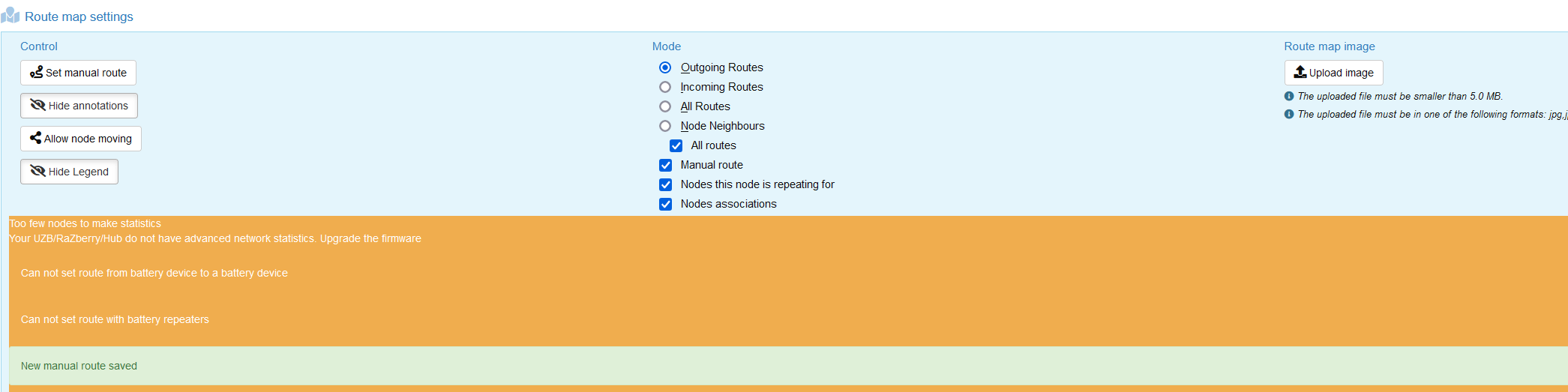

Route Map has no Data
Post by J.nissen »
I use Razberry gen. 7 +
I had no Rout Map .
An Errormessage Occur
Too few nodes to make statistics
Your UZB/RaZberry/Hub do not have advanced network statistics. Upgrade the firmware
Can not set route from battery device to a battery device
Can not set route with battery repeaters
The current firmware version is: 7.11 [Bootloader: 1766938484]
Greetings from germany
Jörg
