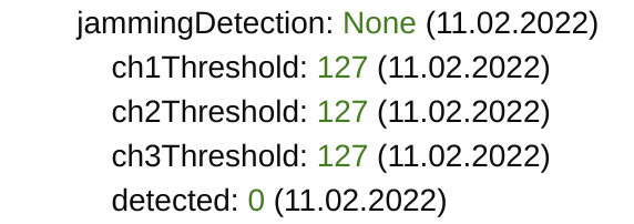

Currently this is not in the UI. The dataholder zway.controller.data.statistics.jammingDetection.detected.value is set on detection. Basically, you can subscribe to this dataholder and make a UI element.

Re: what is the easy way to raise a notification about jamming detected
You can even add it to the modules/ZWave/index.js and make a pull request. Meanwhile this is on our long TODO.
