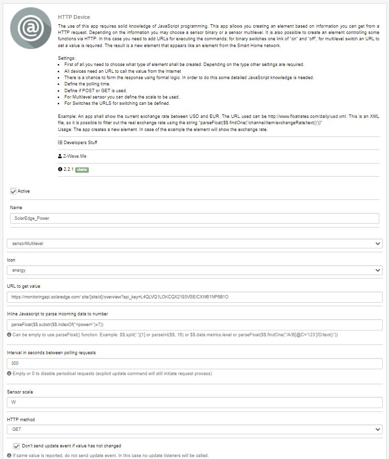

There are several approaches. One approach is to use the "HTTP Device" app and have the app poll the SolarEdge API every 5 minutes. Just add the app and with luck, you'll have a new Z-Way device that shows the power value. Something like the following:
HTTP Device.JPG (115.66 KiB) Viewed 34728 times
Once you have the app properly reporting the power production value (you will have to tweak the URL and you may have to tweak the Javascript parsing), the final part of this approach is to create an automation Rule (i.e., an If-Then-Else statement) to turn your water boiler on when the value of the HTTP Device is > 9.000 (check the option "Don't send On command, if device is already turned On, similarly for Off) and select Activate reverse event under the Else tab.

Thanks. Did not know it is so simple approach. Tryed 'HTTP Device' with exchange rate example and it works just fine.
But looks like SolarEdge's .xml has different (?) structure and is not returning value. It says: "This XML file does not appear to have any style information associated with it. The document tree is shown below."
Tryed two different Javascript approaches. First is your suggested code, the other one is: "parseFloat($$.findOne('/overview/currentPower/power/text()'))".
Neither of them returns a value.

2. Instead of making any assumptions about what gets returned from the https request, change the Inline Javascript to the following:
debugPrint("HTTPS returned:",JSON.stringify($$)); parseFloat('1234.5')
3. Ideally, the log file will contain the string "HTTPS returned" followed by the text that needs to be parsed. The log file should also reveal whether the https request was successful. The Z-Way UI should display 1234.5 for the device's value.
4. If I had to guess, the Javascript response probably needs to look something like the following:
var https_resp = JSON.stringify($$); parseFloat(https_resp.substr(https_resp.indexOf('<power'>)+7))
By adding debugPrint() statements into the Javascript, I expect you'll meet with success. Note that instead of waiting 300 seconds for the next poll interval, you can manually refresh the device's status by clicking on the timestamp on the UI.
If you're stuck, just send me a PM by clicking on "seattleneil" where there's an option to send a PM.

Included debug line into code: debugPrint("HTTPS returns:",JSON.stringify($$))
In log file I could see full string returned from solaredge API. Great thing! <power> is returned as "power".
With few 'try and error' attempts I finally wrote this code:
debugPrint("HTTPS returns:",JSON.stringify($$)); var https_resp = JSON.stringify($$); parseFloat(https_resp.substr(https_resp.indexOf("power")+7))
I also wrote 'W' sign into the 'Sensor scale' field. I know it is not scale but it works and Watt sign follows number shown on my Dashboard.
