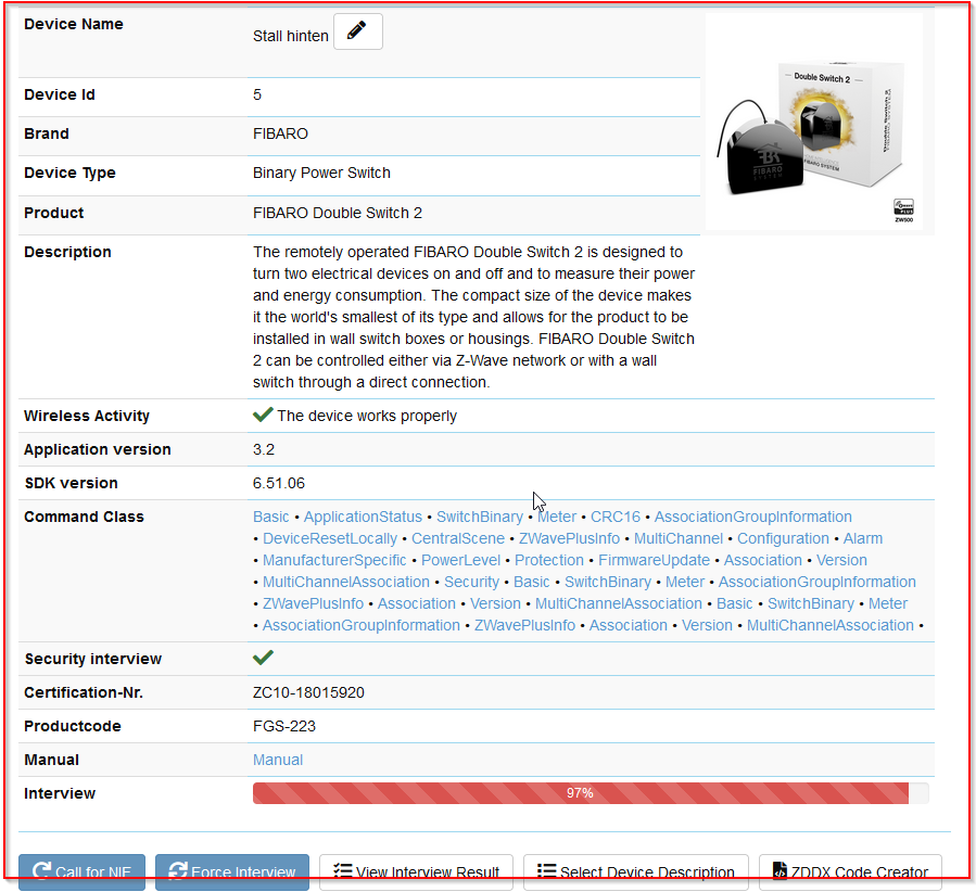

Interview Fibaro 223 not complete
Posted: 09 Apr 2022 21:30
by J.nissen
Zway v.3.2.3
Razzberry 7 pro SDK Version: 7.17.00
Interiew failed for "Version"
How can I Interview Complete
Thanks

Version is not important.
You can try Force interview many times.
Or just over-ride the Version part.
your ip:8083/JS/Run/zway.devices[5].Version.data.interviewDone=true

We see in the new v3.2.3 that it happens with Fibaro FGS-223 (and may be some other devices). If you press Force interview or re-include, it will be solved. Or do as micky1500 said.
This is some new floating bug and we are working on it.
