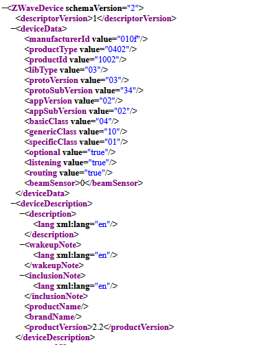

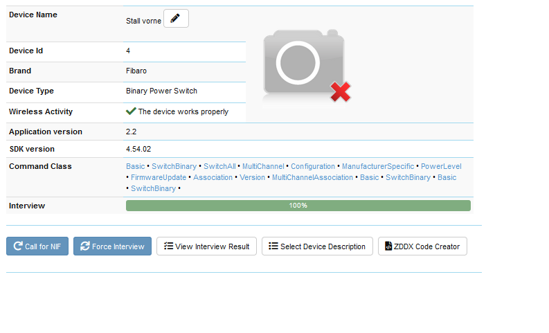

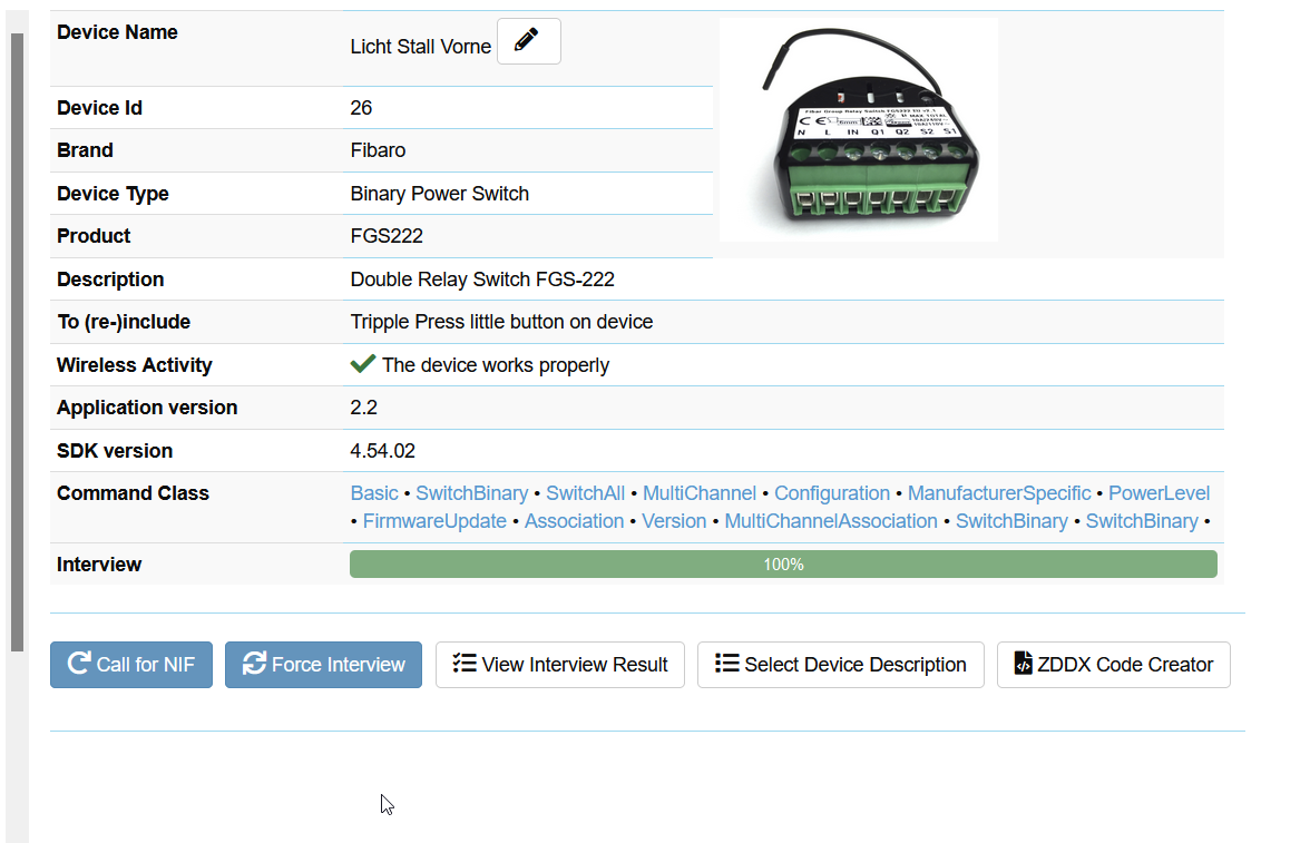

on v 3.2.2 for my Fibaro FGS 222 was an ZDDX Description Found.
On new Version v 3.2.3 for the same Device not ?
Is there an Reason ?
Version 3.2.3
Version 3.2.2
Greetings from germany
Jörg

yes, then Description for other Devices are found.
This is the Created File with ZDDX Creator
Wich Tags are Used to find the Description ?
Jörg

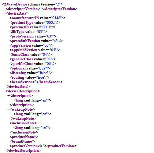

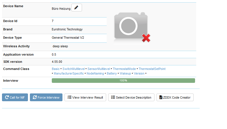

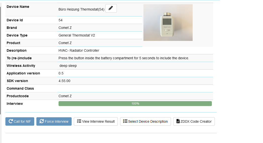

on an Comet Heating Thermostat I can Select the Device Description, but after Save Buton, the Description is not Save.
On Version 3.2.2 it works fine
Jörg

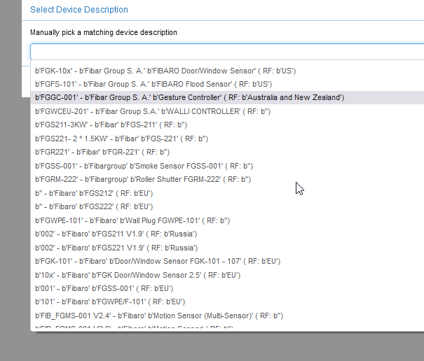

Re: ZDDX for FGS 222
Thanks for the access. The problem is in the update of python to python3. Please go in /opt/z-way-server/ZDDX and run
python2.7 MakeIndex.py
If you don't have python2.7, open the MakeIndex.py and remove all encounters of
.encode('utf-8')
save and run
python3 MakeIndex.py

Post by J.nissen »
Hello Poltos,
thanks a Lot. It works fine.
