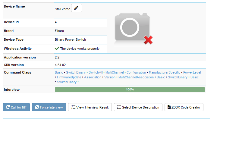

on v 3.2.2 for my Fibaro FGS 222 was an ZDDX Description Found.
On new Version v 3.2.3 for the same Device not ?
Is there an Reason ?

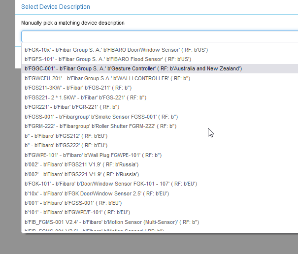

Sure you have the database in /opt/z-way-server/ZDDX/ ?
Re: ZDDX for FGS 222
Posted: 11 Apr 2022 08:44
by J.nissen
yes, then Description for other Devices are found.

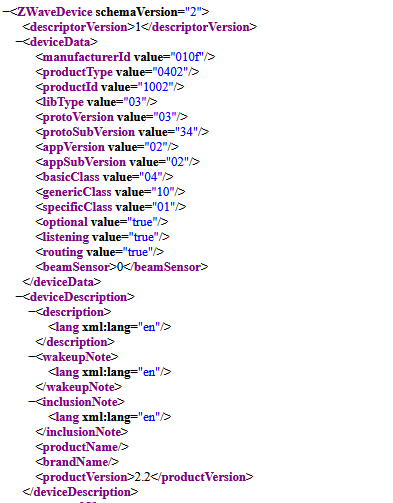

This is the Created File with ZDDX Creator
Wich Tags are Used to find the Description ?

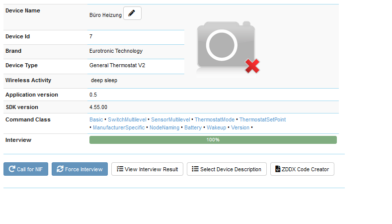

on an Comet Heating Thermostat I can Select the Device Description, but after Save Buton, the Description is not Save.
On Version 3.2.2 it works fine

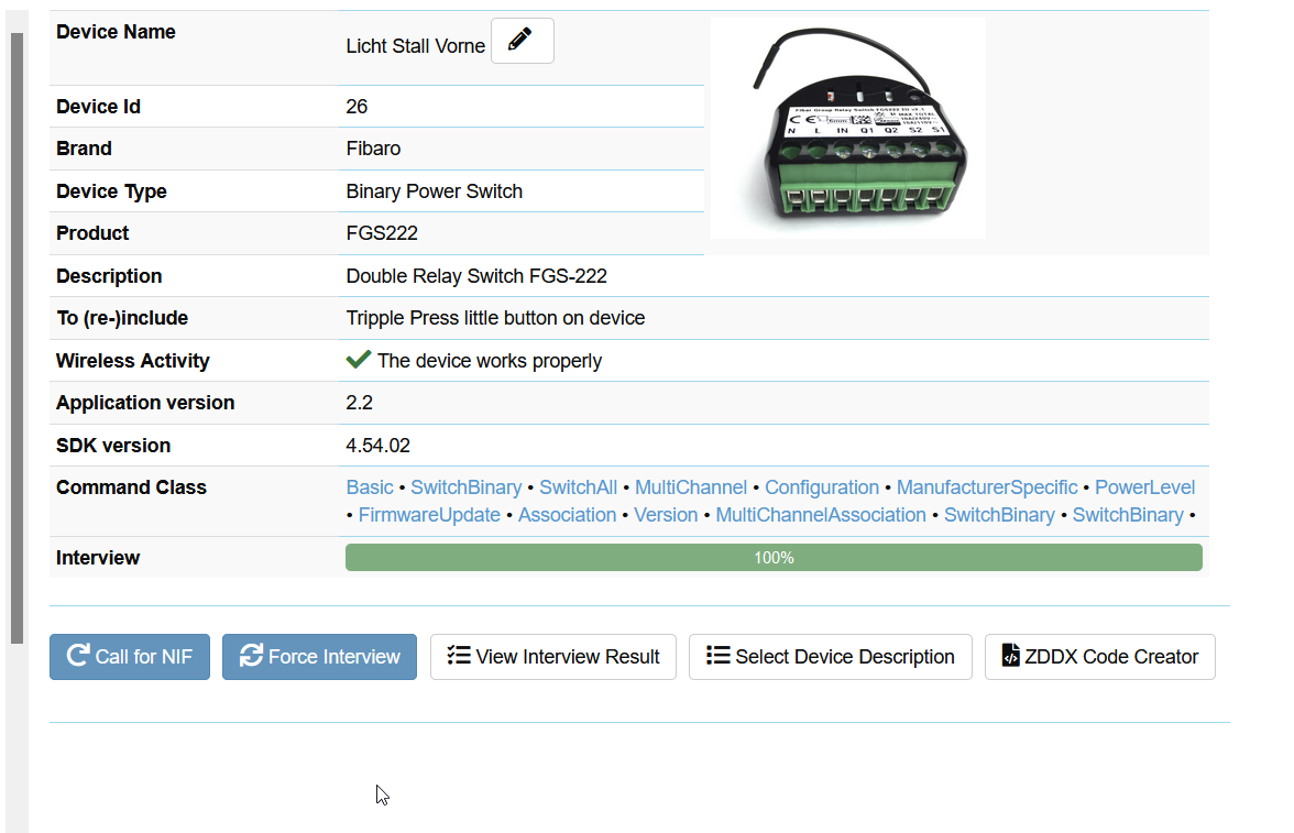

There are any Incorrect Value in ZDDX ( Sample FGS-212, 665-010f-0400-100a-03-03-2a-02-01.xml )
- Missing ProductCode
- wrong Description
- Missing Image
On my Local i have correct this.
Who correct this on general Database ?
