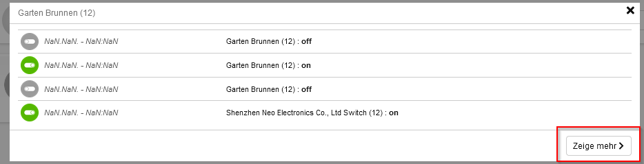

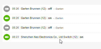

Timestamp on Device Eventlog Wrong Shows NaN.NaN
Post by J.nissen »
please see follow Images
It is also if I change Language to English....
grettings
Jörg
Greetings from germany
Jörg

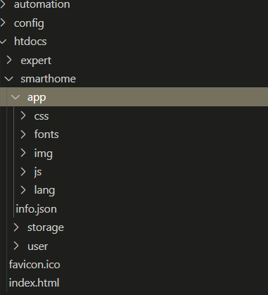

wich files must change ?
I am missing directory Views
Jörg
Xel4ek
Joined: 22 Apr 2022 22:30
Re: Timestamp on Device Eventlog Wrong Shows NaN.NaN
Post by Xel4ek »
list of changed files:
htdocs/smarthome/app/views/elements/widgets/eventModal.html
htdocs/smarthome/app/views/elements/widgets/mobile/eventModal.html
htdocs/smarthome/app/views/events/dropdown.html
Those files are built in in app/js/build.js. You will need to edit it carefully. Or replace the full smarthome folder with the one from git
