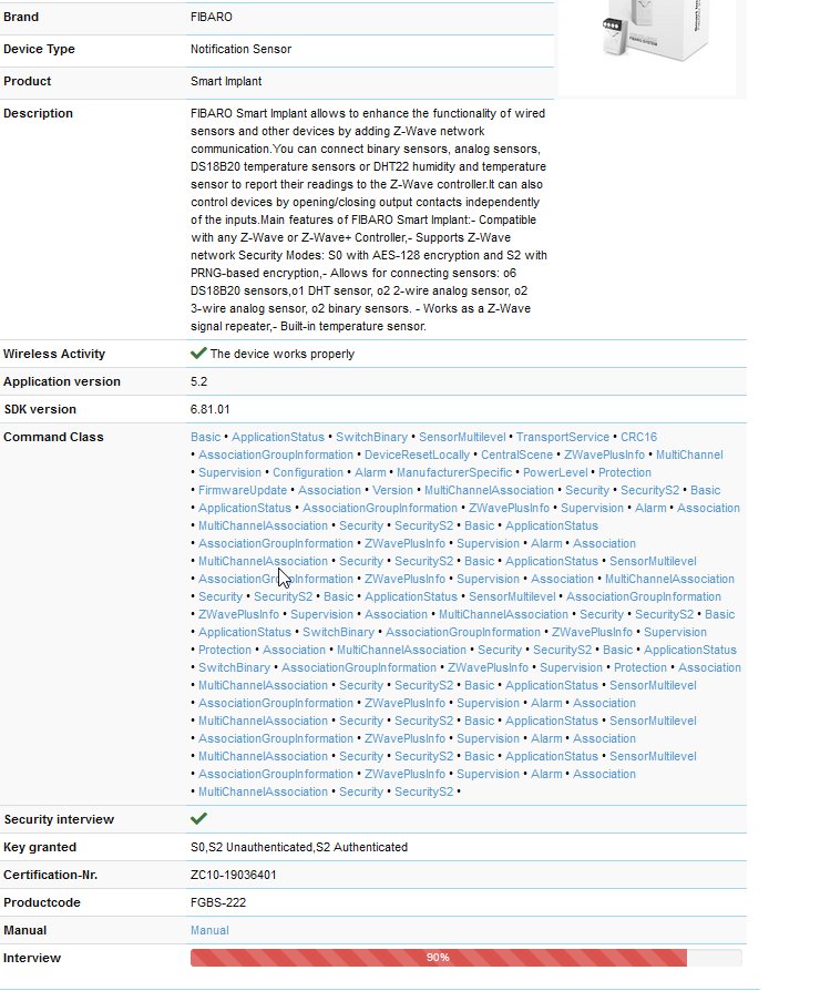

Include the univesal Sensor from Fibaro ist very difficult.
If I retry the Inclusion, irgent when it goes then. I must then but also times 10 - 20 times to get the inclusion again.
In the Fibaro HCL Lite this goes without a problem.
What can be the reason
Zway 2.3.2 with Razzberry pro

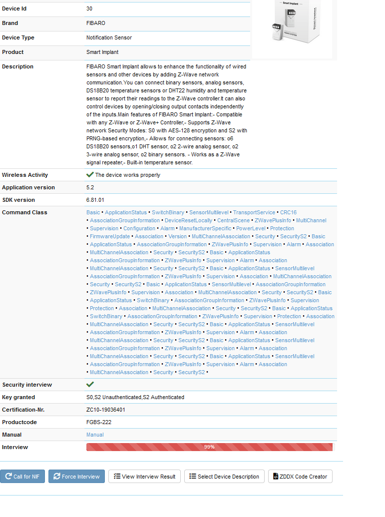

in the meantime I have pressed 1000 times more on the interviews of the individual classes and am now at 99%. So now only the class for the version is missing and this is not so important.
Since I often tinker with Universal Sensor, this behavior is only annoying

Please show us the View Interview Result. Then we can see which Command Class is missing.
I just struggled with an old universal Sensor, you are using a smart implant. Maybe they are similiar, as the smart implant is
the successor of the universal sensor.
This helps for mulitchannel interview problems if I remember right:
http://192.168.0.148:8083/JS/Run/zway.d ... wDone=true
You have to use your IP Address and your device number.
If there is another class missing, you can use something like this:
Have Fun,
Nico
Re: Fibaro Universal Sensor Inclusion
Posted: 24 Apr 2022 22:20
by micky1500
It's random.
Command Class:- Version, ManufacturerSpecific, Association.
or others
I've been getting S2 missing for devices that are too old to support it !
But after 5 - 20 attempts at Call for NIF, or Interviews. It gets resolved.
I get from that. There are no classes missing ! (It works 100% after multiple tries)
It's just timeouts when doing the Interview process.
Been like this for about 2 years.
No fixes given, just work arounds (override the failed interview)
Greetings.

O.K. understood. If I have an problem with inclusion, it´s not possible to do it via NIFR or force interview.
I had to set it via weblink to true.
