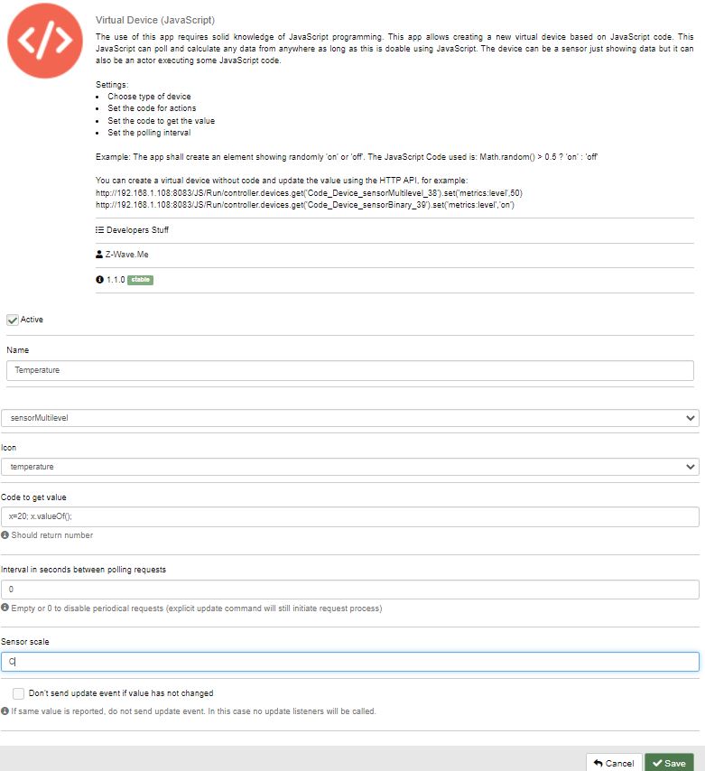

1. Using the web UI (i.e., point your browser to http://[Your Z-Way IP address]:8083), click on the configuration menu in the upper-right corner and select "Apps". Search for and add the app "Virtual Device (JavaScript)".
2. Fill out the template similar to what appears in the screenshot.
virtual device.JPG (88.29 KiB) Viewed 12645 times
3. After you save the virtual device, you should now have a new Z-Way device called "Temperature" that you can add to your dashboard. As configured in the screenshot, the default value is 20C.

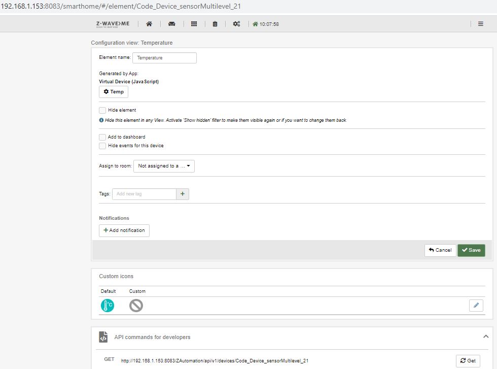

4. Next, you need to determine the deviceID for the sensor device you created in the previous step. It's going to be something like: "Code_Device_sensorMultilevel_XX". To do that, locate the sensor device in the web UI (use the Elements icon) and click on the gear icon for the sensor device. The deviceID will appear in the browser URL and will also appear in the the API commands for developers section. As you can see in the screenshot, my device is "Code_Device_sensorMultilevel_21"
Sensor Device.JPG (61.75 KiB) Viewed 12645 times
