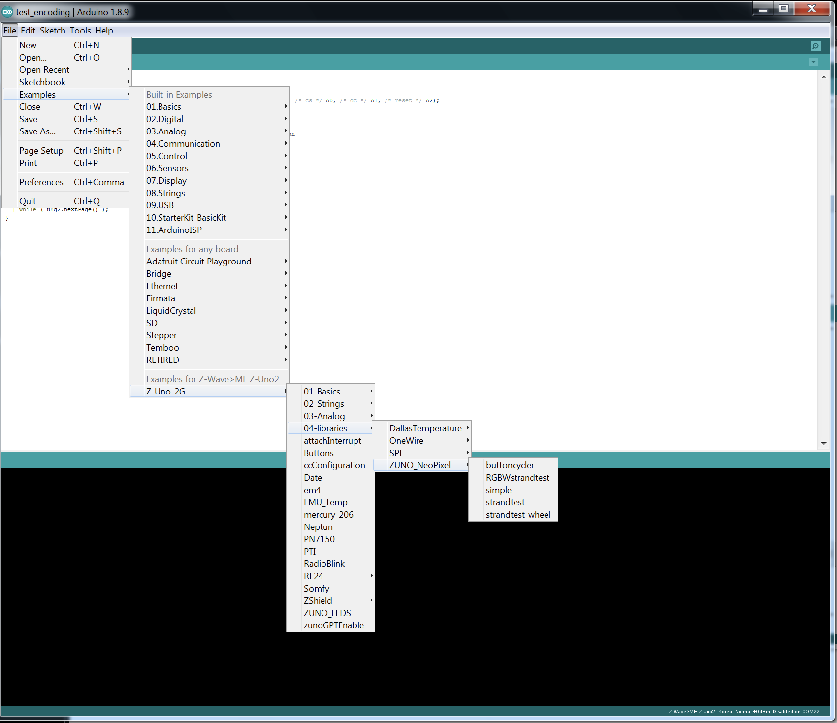

The API has changed since the first version. Now the library supports the ability to work with several tapes at once. Try the examples that come with the Z-Uno core (see the screenshot). Good luck.

Post by Zeloz »
Thanks, the example works for the G2
