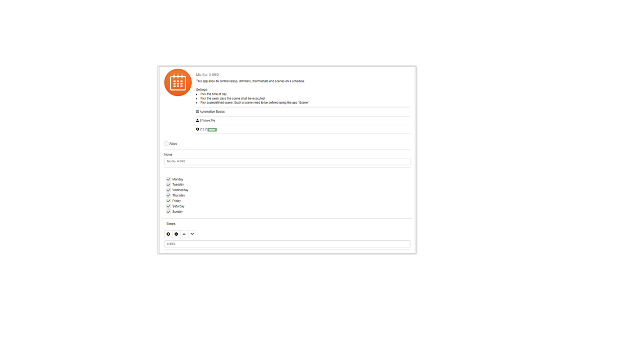

Posted: 26 Jul 2022 20:24
by D55m14
I tried to use the app "Schedule" with "0-59/2" in field Times . I don't know if is correct .(see attachment)
