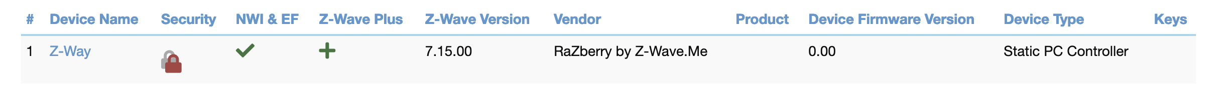

trying to figure out howto get my razberry to latest firmware.
It comes with 7.15.0 from what I can see in expert ui.

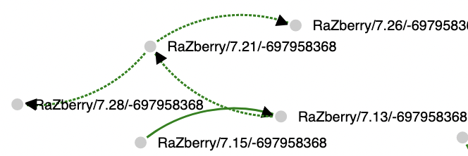

The easiest method as discussed in another thread, use token "all". You will then see 7.21 as an update. Update to it and after the upgrade is done, go back to the firmware update and use the token "all" again and then select 7.28 as the upgrade.
You do know that this firmware is not a general release? They still have some issues to fix. This is why these updates are not showing up in the firmware update.

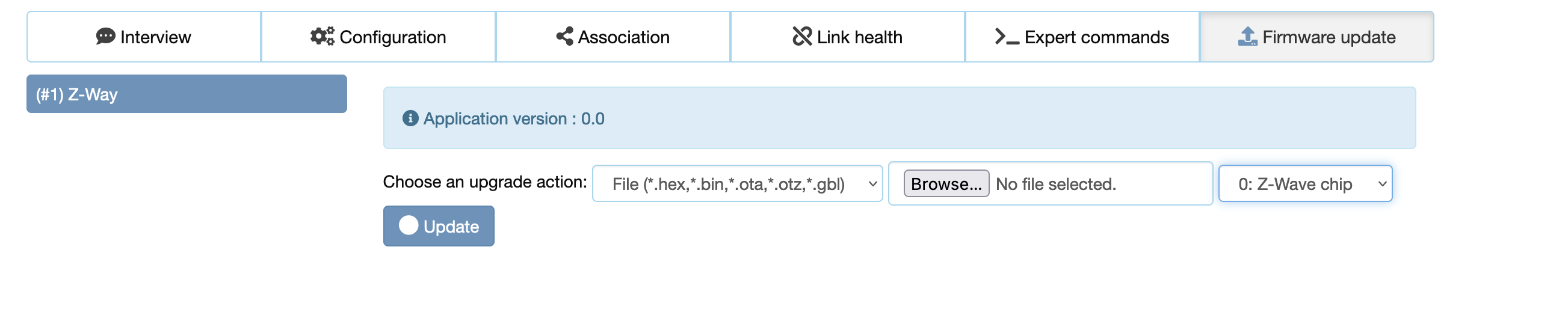

No I do not know it's not general release. Doesn't say that on the firmware page?
Hmm on my firmware update page I only have the option to upload a file or insert an url. (fresh install of z-way)

edit: perhaphs you ment all on graph page? If so would "active" mean stable release and "all" dev+stable releases?
Still don't understand how to follow the versioning in the graphs, those number really says nothing to me without any doc.
Arrows go 7.15 -> 7.13 -> 7.21, wouldn't it be 7.13->7.15.->7.21 ?

Also getting confused on what "firweware/sdk" I really have on my device. 7.15.00 does not seem to exist.

Then looks like they finally official released it.
You are not looking at the correct page, go to Network -> Controller Info and then look near the bottom for firmware update. The page you're on is usually where you update the firmware for Z-Wave devices. There was a thread on all of this under the correct category. You might want to look at the Razberry sub-forum and look at that thread before proceeding any further.

Thanks :D
That page worked better.
