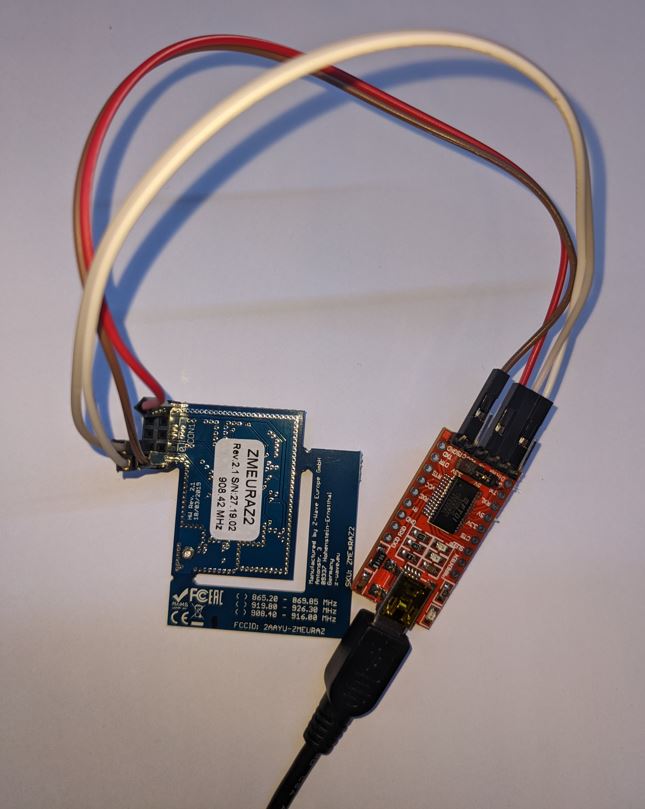

Definitely possible. I do this using an inexpensive USB to TTL Serial Converter (4 converters for $10.88 - https://ww.amazon.com/dp/B07XF2SLQ1) and 4 jumper wires ($6.98 - https://www.amazon.com/dp/B01EV70C78). Note that the converter has a mini-USB connector (not USB-C or micro-USB) and does not use a genuine FT232RL chip (functionality seems the same as a genuine FT232RL, but the serial number is not unique which likely will result in random serial port assignments when using multiple converters on a single host).

The RaZberry uses 3.3V (pin 1 of Raspberry Pi), do not use pin 2 (5V). The remaining pins are correct. As shown in the picture, I use pin 9 for Ground, pin 6 is also Ground - either pin is correct. If you purchase the knock-off USB to TTL Serial Converter that I use, be sure to set the jumper on the serial converter to 3.3V.
As a precaution, before connecting the RaZberry board to the serial converter, I recommend testing with a voltmeter to verify the red wire/brown wire voltage is +3.3V.
If you install an Ubuntu-compatible distro on your VM, you should be all set. I use Linux Mint 20.3 (Ubuntu Focal) with Z-Way for Ubuntu x64.
