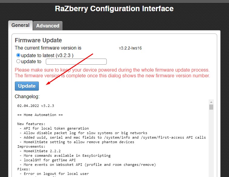

Z-Way software 3.2.3 Razberry 7 (firmware version is: 7.26 [Bootloader: 1766938484]) firmware update does not work
When updating from the Z-Way settings section, a page exits.
The IP-RaZberry site does not allow you to establish a connection.
What can be done?
I can't open tab
Until the problem is solved, how can you reboot and shut down the Raspberry Pi without using the terminal.

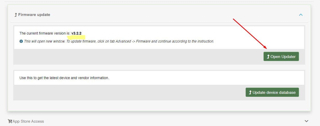

Z-Way.
Clicking the Open Updater button opens a blank page.
Moreover, this situation also occurs on another Raspberry with Razberry 2

When you click on Upgrade button, a page with the UI shown above should open. I got you that you have a blank page.
Please open the browser console to see why the page is blank. You can also try to access the page directly: it is http://RPi_IP:8084 (same as for the UI, but with port 8084 instead of 8083). What do you see here?
I would assume that the webif service (it is serving the 8084) is not installed by you (if you installed only z-way-server and not z-way-full (meta package that includes z-way-server, webif and zbw). Use our script on our https://z-wave.me/z-way/download-z-way/ page to install the full Z-Way will all dependencies.
Another possibility is that the webif experiences errors due to libraries. Please do "lsb_release -a" and show us

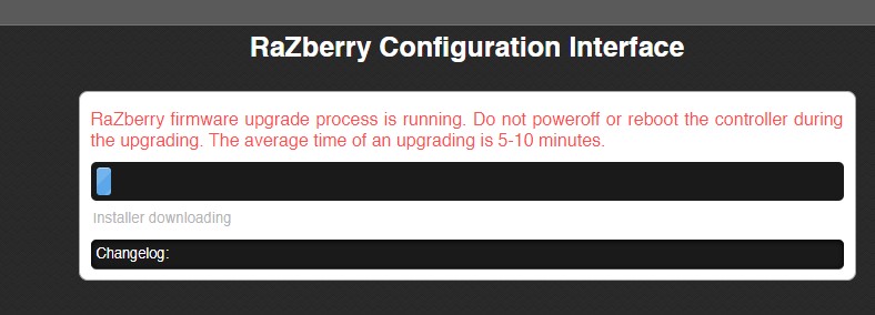

In the interface
The update can last indefinitely, and will not end.
