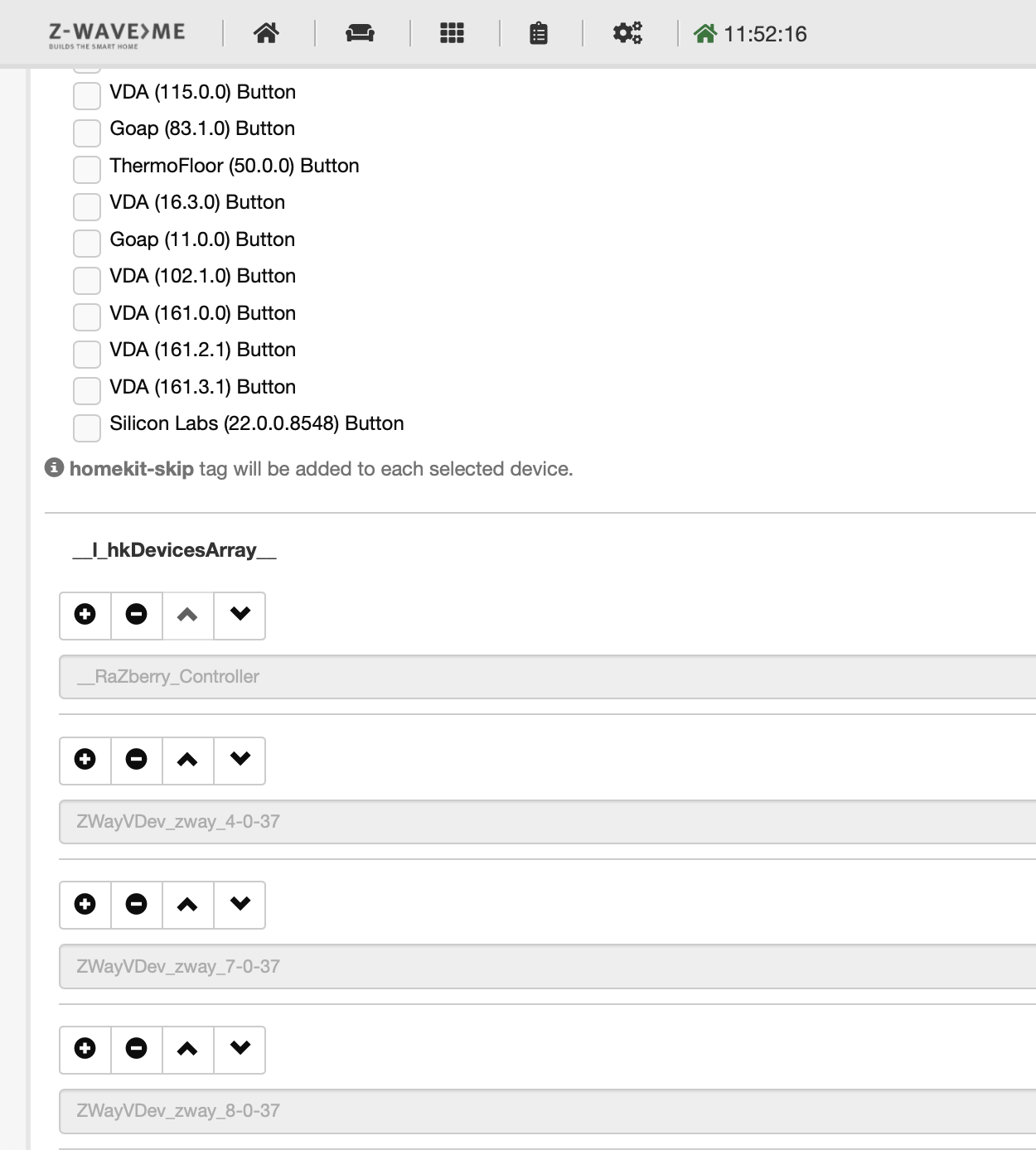

Just starting with zway. And I added a multi sensor… now homekit doesn’t work with UV sensors etc as yet.
So I’ve ticked them in the HomeKit app to not show in HomeKit, but they still show up as unsupported in HomeKit…
How do I flush them out?

Hi, remove unused devices from hkDevicesArray. After that, the list of home kit devices on the phone will be updated.
Снимок экрана 2022-08-23 в 11.52.15.png (149.03 KiB) Viewed 5269 times
