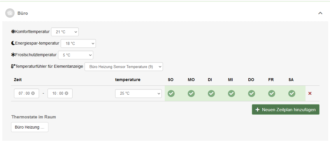

can someone explain me the heating control ?
What / what for is frost protection temperature ?
When is this setting used
What is energy saving temperature ?
When is this setting used ?
What is comfort temperature ?
Is the setting correct here? I would like to have the heating at 25 degrees during the day.

Hello Polto,
Thank you for your explanation. However, I must have asked imprecisely. :-)
When are the tempratures used by Zway ?
The values I set ( 7:00 am to 10:00 am , 25 degrees ) are ignored.
Do you have any idea what I am doing wrong here ?
