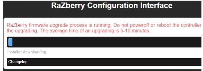

I tried to update as well and the message below remains unchanged for a very long time ( > 16 hours). After that I restarted the system and everything was as it was before. Trying again to upgrade to 4.0.0 gave exactly the same result.
sw update.jpg (30.54 KiB) Viewed 12953 times

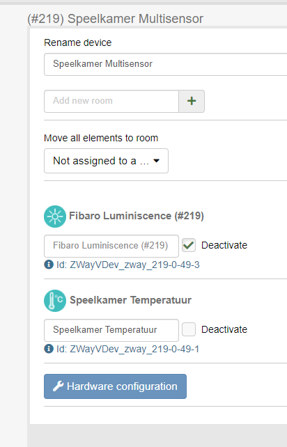

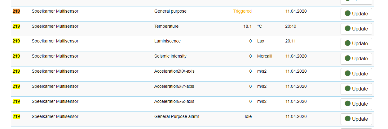

I just upgraded but now all fibaro multisensors (FGMS-001) are only showing luminsense and temperature, motion is gone...
In expert interface it still looks good... how can I get it back ?

I have exactly the same problem: I have 3 of these FGMS-001 sensors, all 3 are missing the motion sensor after upgrading to 4.0.0

Yep, I have it with all of them which is quite a problem, all motion based automation stopped working
