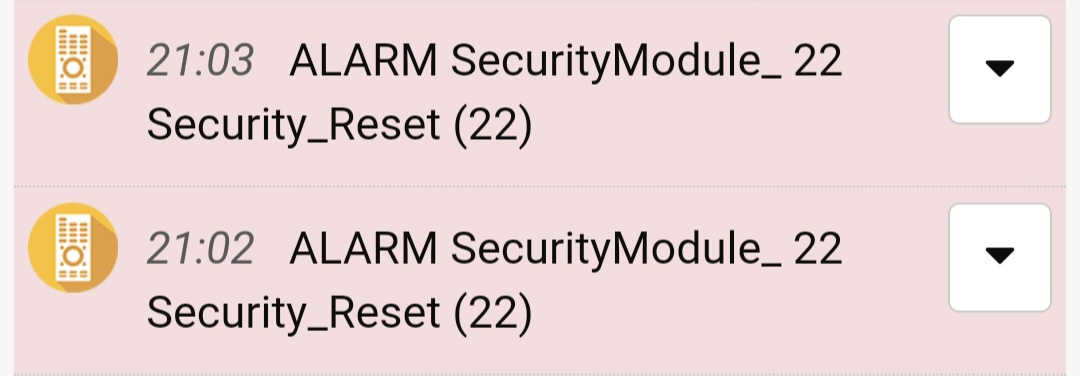

Then today when I left my house, where the z-way controller is, I activated the alarm (the Z-wave.me Security-Module-app), I started getting e-mail notifications as well as these messages in the log:
It appears 5-6 times a minute (with the equivalent amount of e-mails) which is slightly irritating to say the least... Not to mention that the sirens went off, and I had to remove the app before I could get them to shut up.

I think it has nothing to do with your Z-Wave device #22. Here 22 is the ID of the application in Z-Way - in your case Security has id 22.
Security app is creating many devices including Security_Reset. There is some issue with this one. Please make sure there are no automation rules involving it. Make sure the Security app itself does not have Security_Reset device in actions.

It might very well be that's its the app ID, but I've removed that app, and the problem is still there... And there's no rules involving it.
I've now re-installed the Security app (now ID 26) and afterwards I'm getting these errors:
