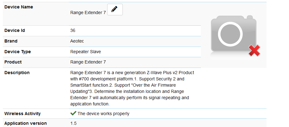

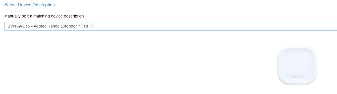

i have add an DeviceImage to an ZDDX File
 <resourceLinks>
		<deviceImage url="https://products.z-wavealliance.org/ProductImages/Index?productName=ZC12-19110019"/>
	</resourceLinks>
On Select Device Description it was Shown, but in the Device Configuration it was Missing.
2022-12-24 16_47_56-Z-Wave Expert UI – Mozilla Firefox.png (27.62 KiB) Viewed 7042 times
2022-12-24 16_48_32-Z-Wave Expert UI – Mozilla Firefox.png (25.16 KiB) Viewed 7042 times

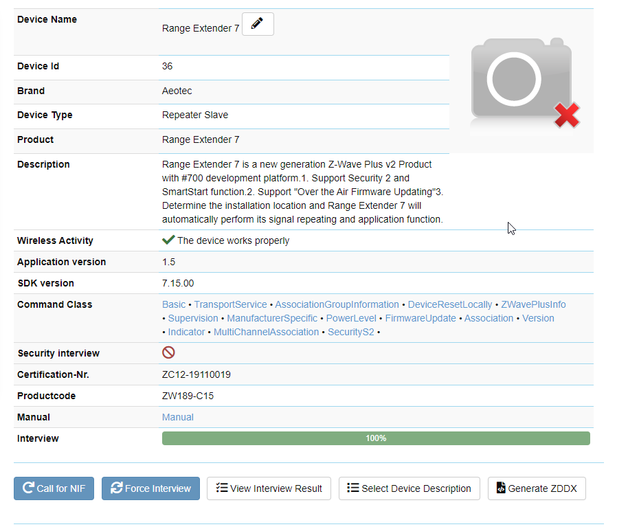

I have test it with different Browsers ig. Edgde, Firefox, Safari
On same Device on Configurationpage Security Interview failure
on Detailspage no Error appears

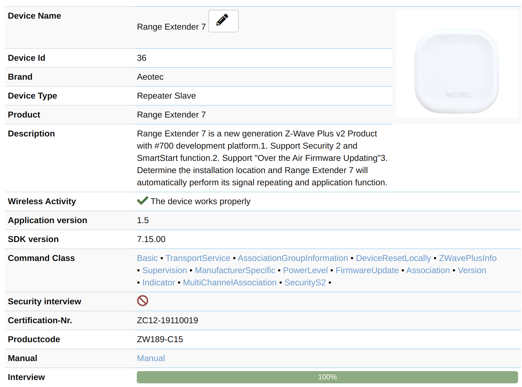

I took the description of another device without image, added your image, and after I cleared the browsers cache the image was shown in Expert UI.
Re: Device Image Missing in Expert Gui
Posted: 29 Dec 2022 05:38
we see the picture:
Screenshot from 2022-12-29 05-36-08.png (289.59 KiB) Viewed 6780 times
The picture points directly to the Alliance web site: https://products.z-wavealliance.org/Pro ... 2-19110019
Please make sure this site opens in your browser. I think it is an internet issue on your side.
