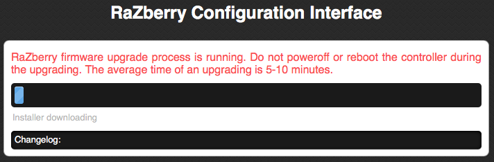

I am trying to perform a firmware upgrade (with SmartHome interface) from 4.0.1 to 4.0.2 on RaZberry 7 Pro, but the progress bar is stuck on "Installer downloading":
Снимок экрана 2022-12-25 в 17.08.47.png (45.49 KiB) Viewed 11687 times
I waited 30 minutes, but nothing changed.

The same problem occurred when trying to upgrade from 4.0.0 to 4.0.1
Re: Firmware update stuck on "Installer downloading"
Please upgrade via apt-get update && apt-get upgrade. We are fixing the issue.
