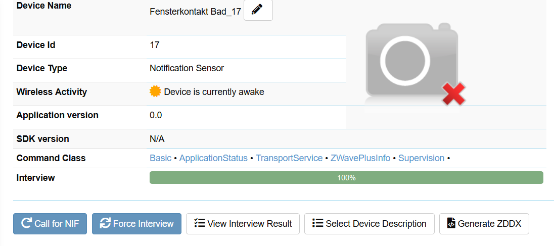

It passed the interview fully and it got device id 17 but I cannot find any device. Usualy new devices (after inclusion) are in the room "not asigned to any room" but in this case there is no device visible.

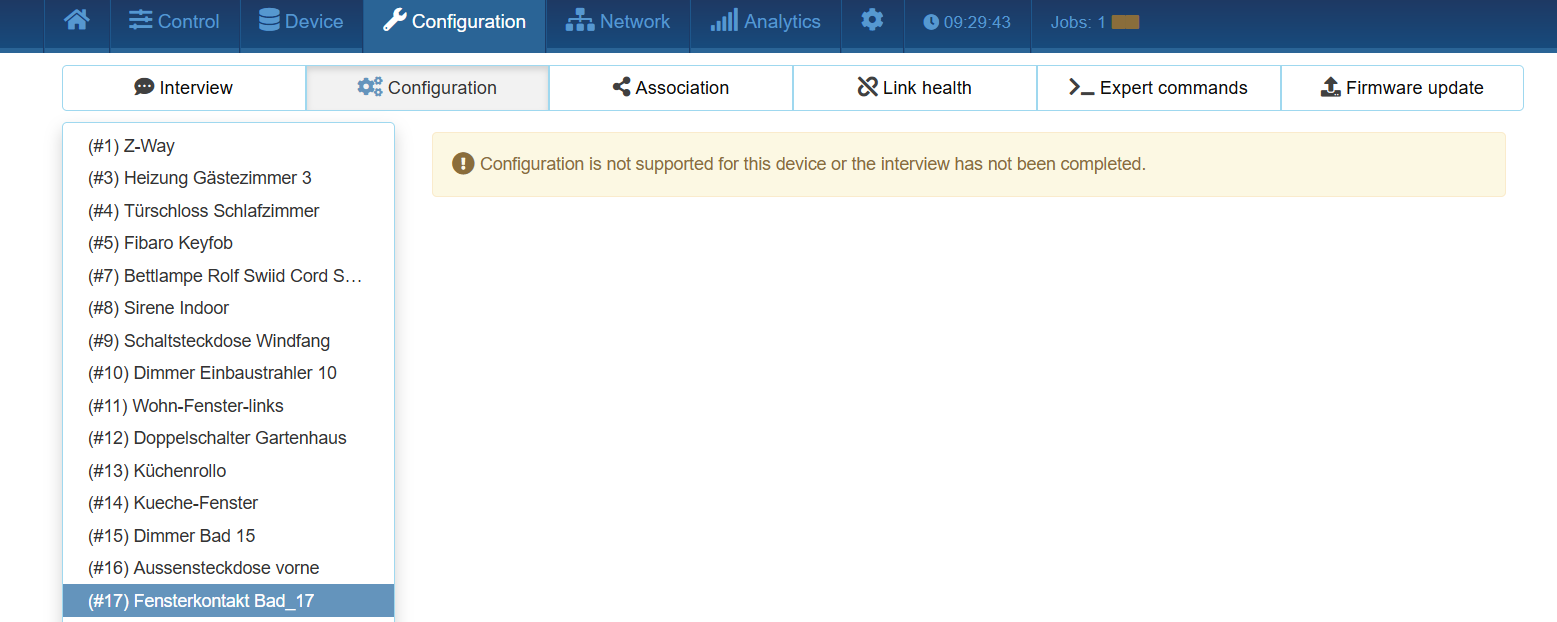

Accpording to the user manual of this device it is a binary sensor that can be configured. But after the successfull inclusion of the device (interview 100%) there is no new device available in any room and it is not possible to change the device configuration because ZWAY gives me an error message.

And when I move the magnet over the sensor (simulation to open/ close a window) the sensor answers with 5 times green LED blinking which means "communication error with controller".
There is something wrong with the inclusion process for this device type.

Your list of supported Command Classes shows only technical classes. Looks like it was included without Security and the device locked its functions. Please include it using Security. Go to Expert UI, Network, Control, and Include the device and grant keys it requested.
Re: Strips Guard 700 Device Description missing
Posted: 30 Jan 2023 12:54
by RolfKunkel
This was the right hint. Now it works. Thanks for your quick help.
