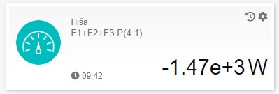

Now after upgrade, meter values are not displayed as before 2.3 kW but as 4.26e+3 W
Is there a way to change it or it is defined by device ?

Where do you see 4.26e+3 ? we should never show such values in the UI...

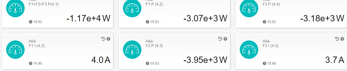

Attached screenshot...

Checked with our R&D. The scientific format is used for only super small numbers and by error is applied to negative numbers too.
This is fixed and will be part of the next release: https://github.com/Z-Wave-Me/zwave-smar ... 6ac3bbe916
