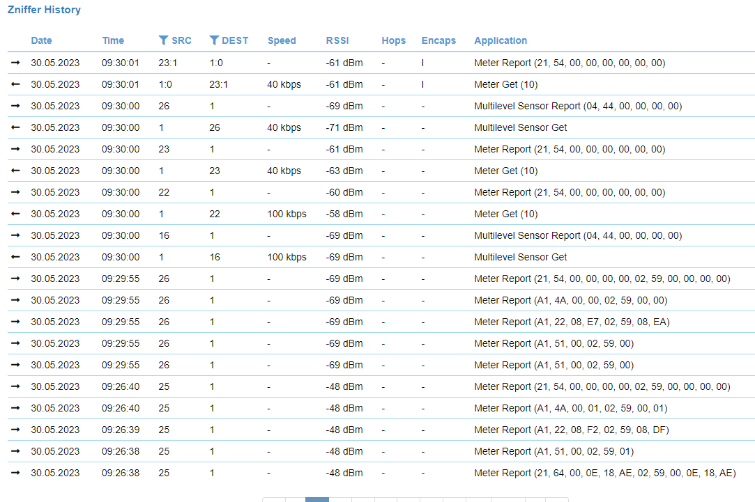

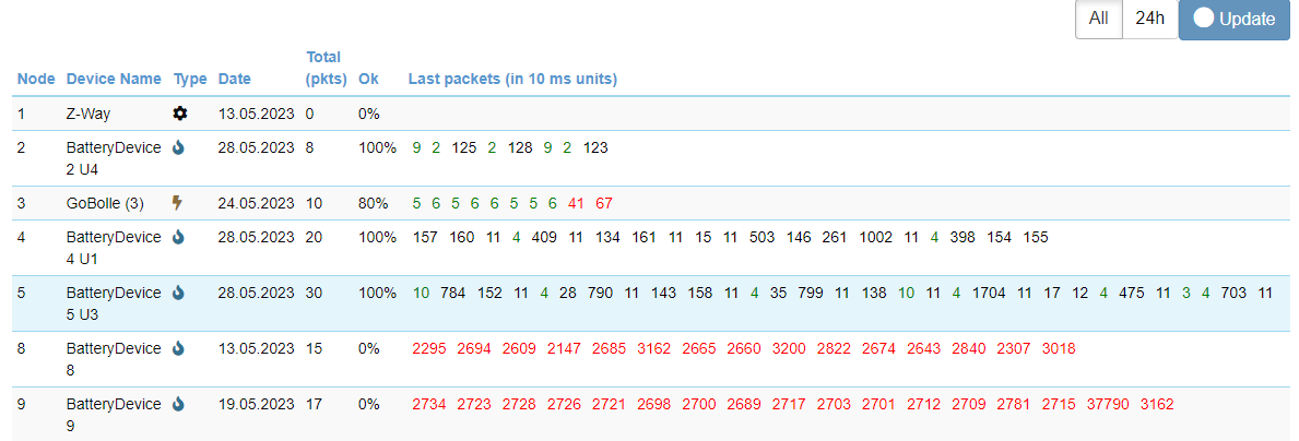

5. Check the signal strength for packets sent to/from the lock by accessing the expert UI at http://[IP address of your raspberry 4]:8083/expert/#/installer/history. What does it show?
Most recent page shows this

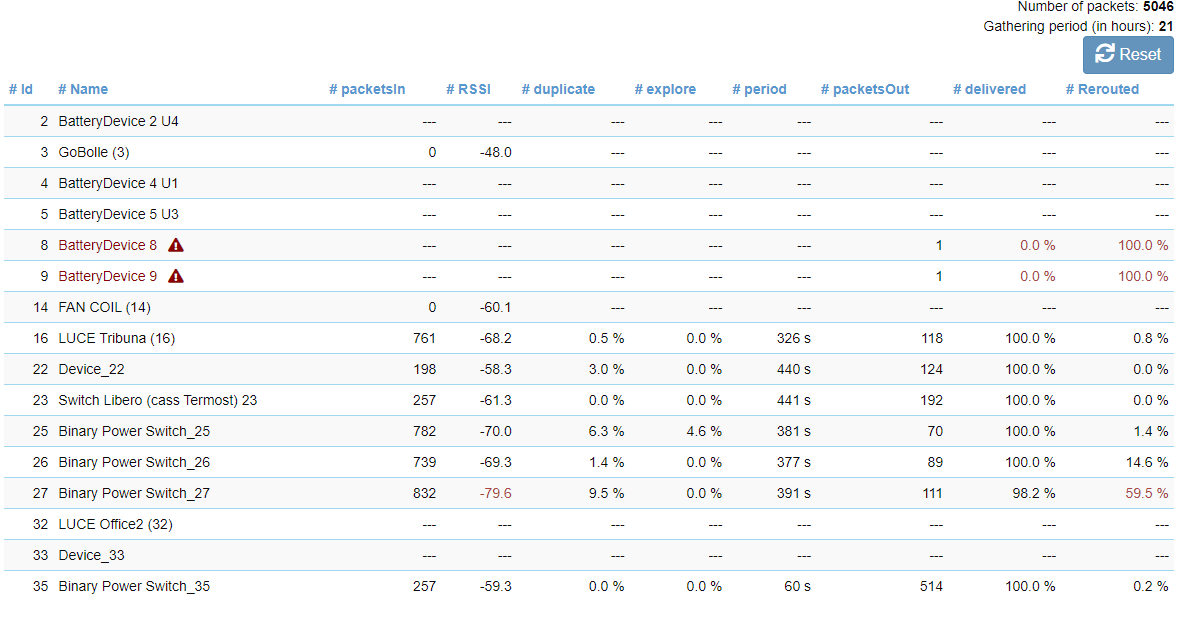

6. Check packets statistics by accessing the expert UI at http://[IP address of your raspberry 4]:8083/expert/#/installer/packets. What does it show?

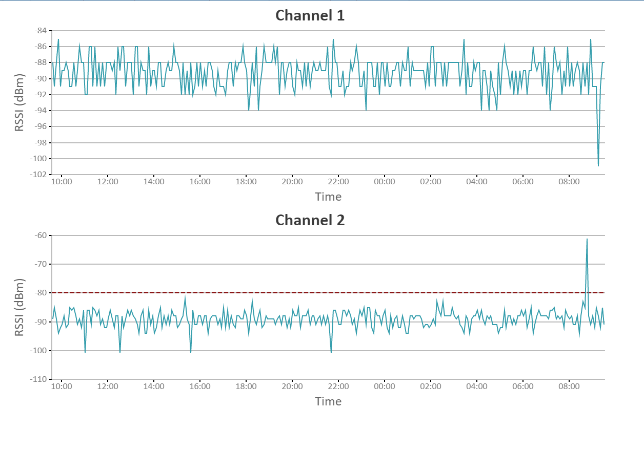

7. Check RF noise by accessing the expert UI at http://[IP address of your raspberry 4]:8083/expert/#/installer/rssi. What does it show?

On the good news side, the information you provided shows you don't have an RF noise issue (channel 1 is used for 9.6 and 40 kbps communication and channel 2 is used for 100 kbps communication). Also, packet statistics show devices 16, 22, 23, 25, 26 and 35 are operating well.
On the bad news side, packet statistics show device 27 routing needs to be fixed (delivery success needs to be 100% and rerouting should be as low as possible). You should be able to fix this by either performing a network reorganization (expert UI->Network->Reorganization) or manually adding a route. In addition, the timing info for device 3 is strange. Although the signal strength for device 3 is excellent, for some unexplained reason, 2 of the 10 packets had unusually large delay values (410 and 670 milliseconds) and 8 packets had excellent timing stats. Note that long delays for battery-powered devices is normal since these devices are designed to only wake up at periodic intervals.
Packet statistics were missing for devices 3, 14, 32 and 33. As a result, not much can be said about these devices. If these devices are switches, you can force packets to be sent and received using the expert UI->Control->Switch->Update All button. If these devices are sensors, meters, thermostats or locks, select the corresponding category in the Control menu and press the Update or Update All button. After you've generated packets, Z-Way should update the packet statistics and timing information for these devices.

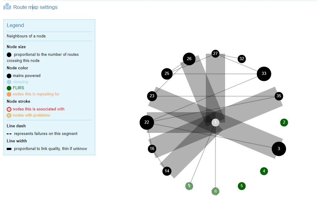

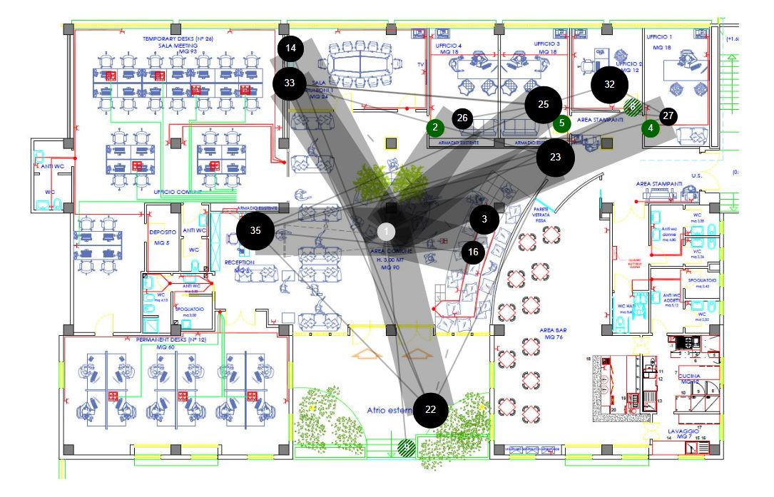

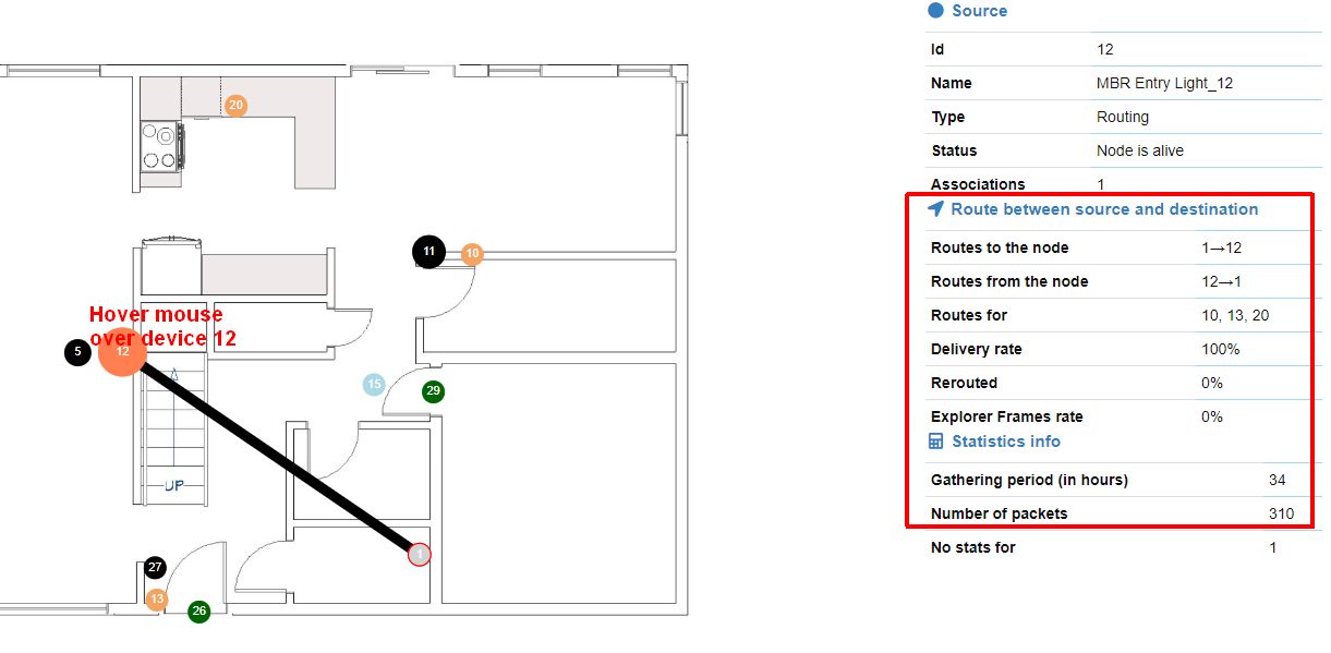

Hi dear, here I am with a more detailed route map where we can see danalock smartlock (in green).
Of course, it says nothing more than before to me but I'm sure could be of help to you.
I don't think there are routing problems. Devices are far from the controller no more than 6 or 7 meters, there are no significant obstacles between and moreover, there are between repeaters devices.

From the route map you sent, it looks like there's a metal wall (shown below in the red rectangle) that's blocking direct Z-Wave communication between the controller and devices 25, 26, 27 and 32. Since there's been no traffic for door locks 2, 4 and 5, I can't tell how packets to/from the door locks were routed.
Although it may seem counter-intuitive to not have the controller in a central location, moving the controller to the location marked by the red X should improve Z-Wave communication reliability since more packets would be directly routed. If you do move the controller, you must perform a network reorganization to update the controller's routing table. You will also need to manually lock/unlock door locks 2, 4 and 5 to wake them up when the reorganization process gets to these devices. In addition, having door locks 8 and 9 not working will cause error messages in the reorganization process, so it would be good to either remove these devices from Z-Wave or re-install the batteries so the door locks are working again. Having a "clean" and correct reorganization (i.e., getting a good routing table and neighbor list) should create a reliable Z-Wave network. If you see an unusual/incorrect/inefficient path in the routing table, you can manually add a route.
Once the reorganization process is completed (you can watch the Job Queue for progress), generate Z-Wave communication to every device and verify packet delivery is 100% and timing is good. The Zniffer history will report how individual packets are routed. You can also see this information on the route map by hovering the house over a device (for example, hover the mouse over device 27 and look on the right side info panel of the route map). My route map is shown below where my mouse is hovered over device 12 with the routing info for device 12 appearing in the red square.

The goal is to have 100% delivery rate with 0% rerouting, and definitely no explorer frames. Note that the routing stats data will only be reported when you have traffic (i.e., the number of packets must be greater than 0). This is why you need to generate Z-Wave communication to every device.

Assuming the routing problem exists as you say, I should have problems sending commands to the locks. That doesn't happen. Every time I send the command they receive it. The state of the widget remains random though. Plus lock interviews happen up to 100% from that position.
The wall you highlight is actually made of plasterboard so no metal plate can shade the devices and then there is no problem with nodes 26,25, 32, and 27.
I can also try to move the controller where you pointed at but with these premises do you think it's effective to solve the status problem? Certainly, the communication with battery-operated devices would improve but I doubt that the problem will be solved also because with the previous version of Zway it had never been encountered.
