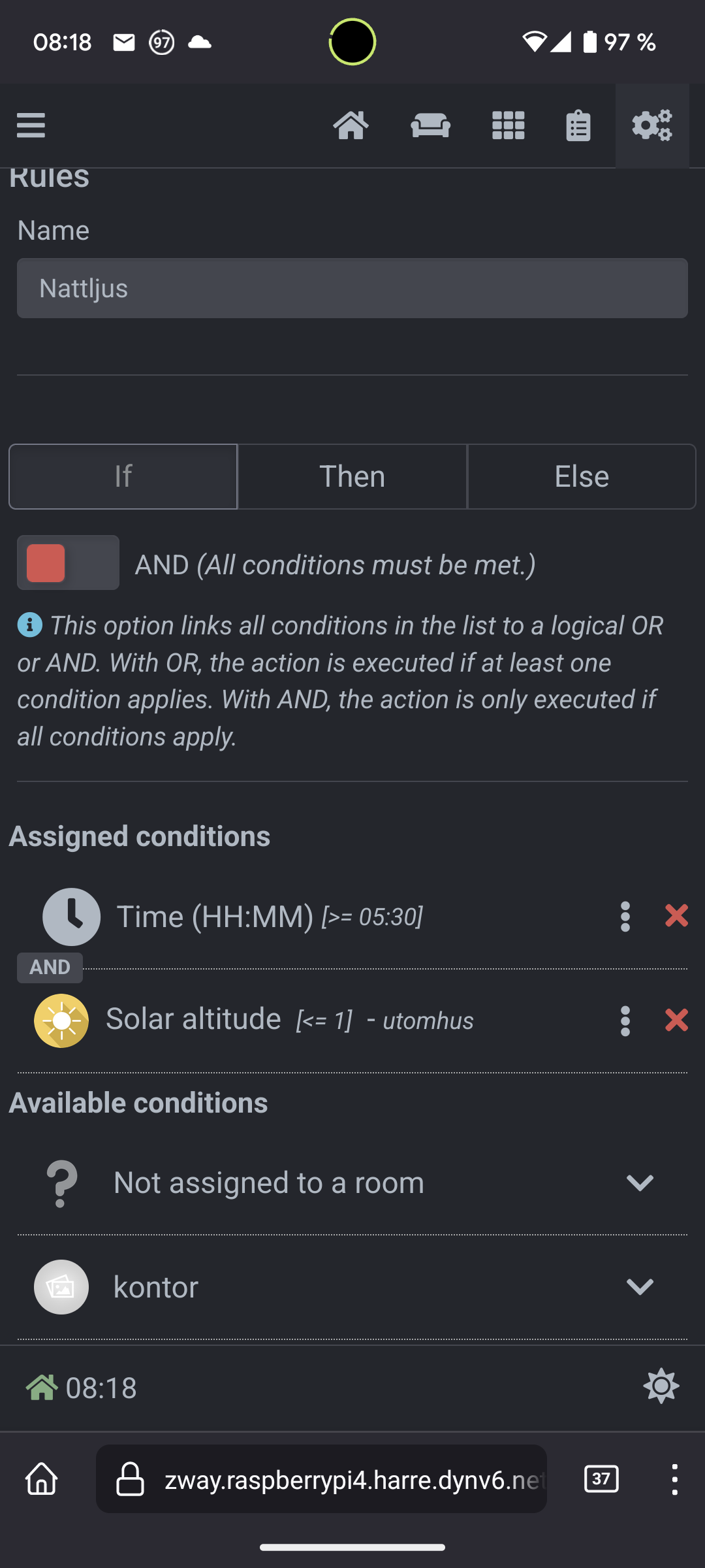

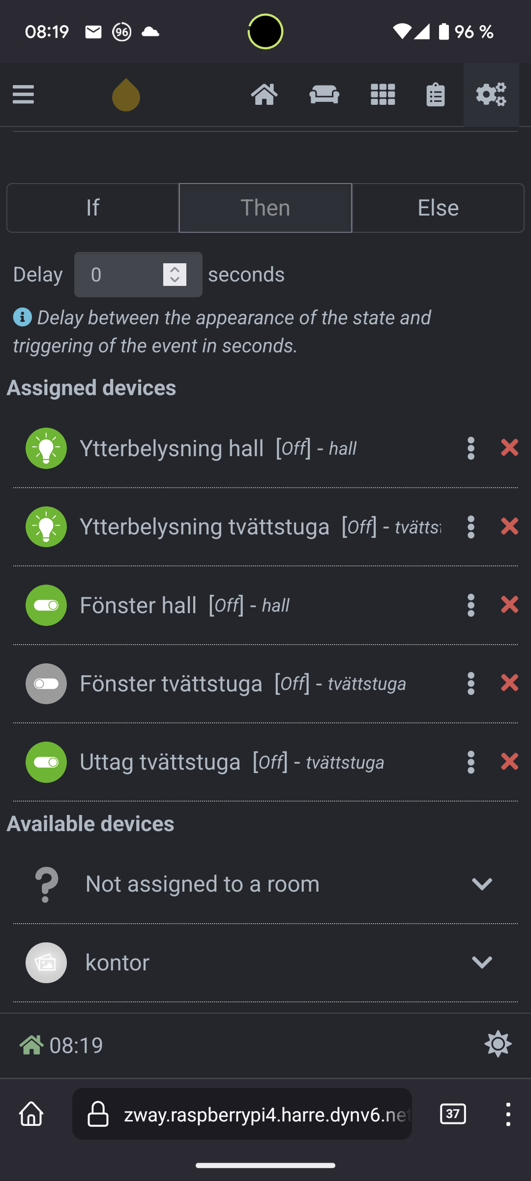

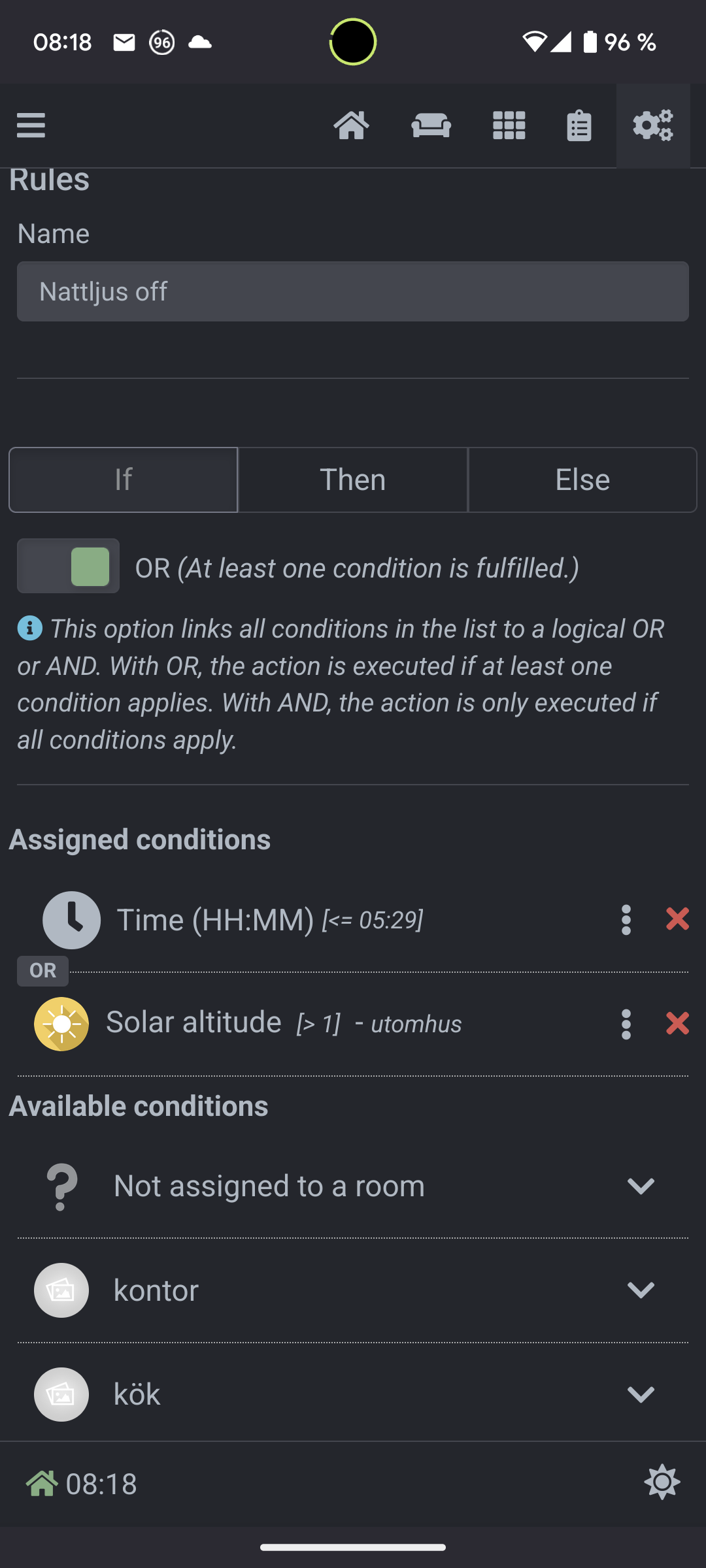

Re: latest update broke automatic rules
I have attached my rules there are two, one to turn on the lights and one for turn off.
The time component is there to have the lights off between midnight and 05:30.
I know the logs are massive, but that's because I don't know what to look for. I was thinking if there's some more debugging I can enable to pinpoint this issue.
This rules have been working without any issues for like two years.

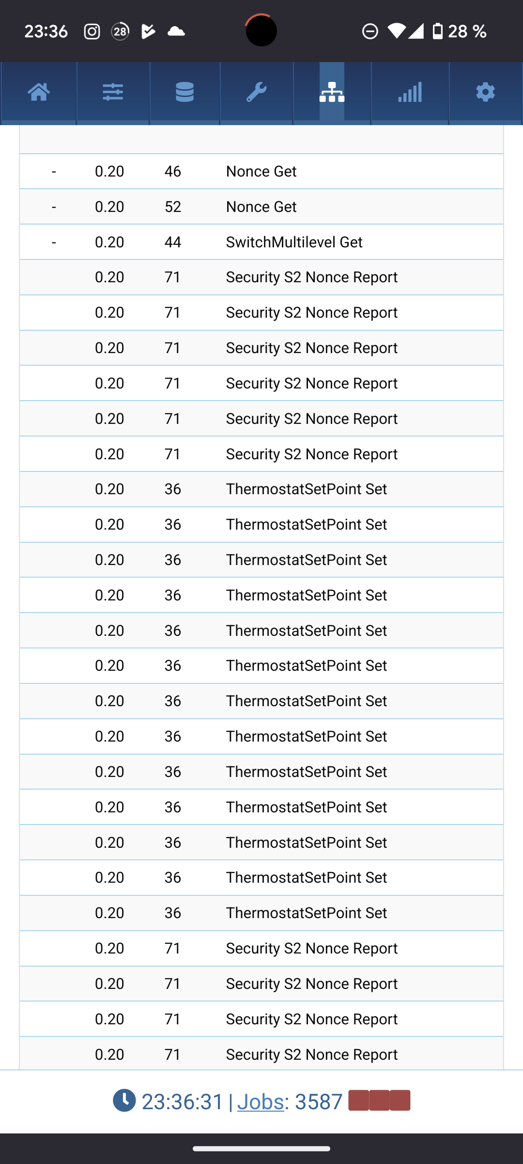

The queue seems to be filling up quite a lot.
It's most the nonce report in the list
