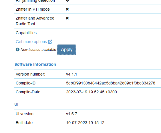

what mean this Message
If I Click on "Apply" Button . Nothing happens.

What is your UUID? The firmware is the latest one? Please paste the controller data screen (or text) under the firmware subtree.
I think it is a bug with a wrong checksum of the version and because of this, it thinks that a new license is available.
Usually, this button is used to get new features after the online purchase.

The current firmware version is: 7.38 [Bootloader: 1766938484]

Is it a problem? We understand it can confuse, but it should not make any problem

I want understand the Button

It looks like CRC mismatch on our server and on the RaZberry 7. So it assumes new device capabilities are available. We will fix it
