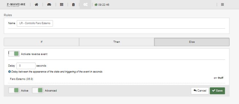

Re: Time Concition in Automations
Could you please show your app settings?

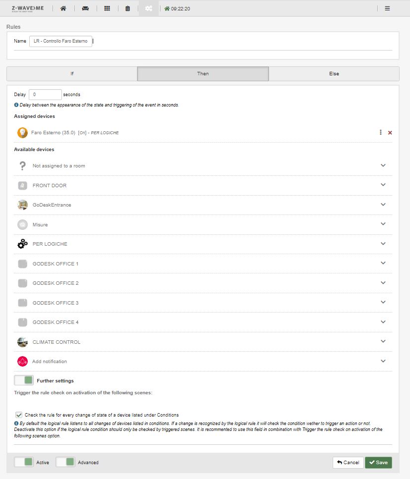

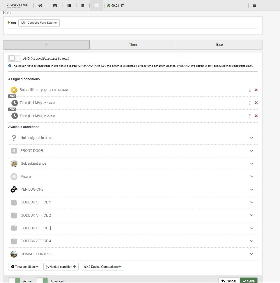

Post by marco »
Hi Poltos,
thanks for your support.
following I report the app configuration that has worked till a few days ago.
Now, to continue use it, I'm forced to remove time conditions.
I tested the app also using only time condition (one ore more) and it doesn't work anymore.
Marco

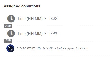

Just tested, this is working for me.
In log I see:
[2023-11-16 17:35:18.959] [I] [core] [Astronomy] Calculate
[2023-11-16 17:35:18.967] [I] [core] HK: updated Astronomy_19_altitude
[2023-11-16 17:35:18.972] [I] [core] Notification: device-info (device-status): {"dev":"Solar altitude","l":"-12.41 °","location":0}
[2023-11-16 17:35:18.983] [I] [core] HK: updated Astronomy_19_azimuth
[2023-11-16 17:35:18.986] [I] [core] Notification: device-info (device-status): {"dev":"Solar azimuth","l":"255.42 °","location":0}
[2023-11-16 17:35:19.058] [I] [core] ---  DummyDevice_16 performCommand processing: {"0":"on"}
[2023-11-16 17:35:19.061] [I] [core] HK: updated DummyDevice_16
[2023-11-16 17:35:19.063] [I] [core] Notification: device-info (device-OnOff): {"dev":"dummy switch","l":"on","location":0}
What is important - that the time condition is only working together with a "device event" - because only the event itself will trigger the rule.
(That's why it was not fired at 17:35:00 - but after altitude device was updated...
Maybe you can check it in log?

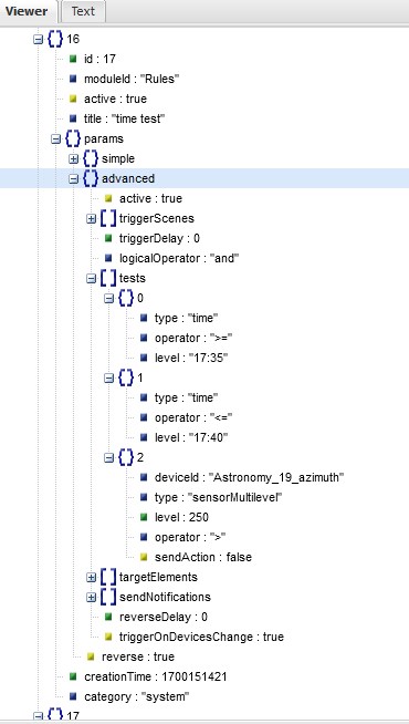

Hi Marco,
there are different things I would check,... Maybe I do not know all of your tests ;)
1) if you remove only time conditions - the automation will work?
2) when the condition will appear (solar altitude <5) ?
(when rule will be triggered without the time conditions?)
Can you check it (time) in log?
3) for checking the time module - create a scheduler automation for testing - switch something on/off at any time and check it
(also check in log)
4) all automations stored in json file
z-way-server/automation/storage/configjson-xxxxxx.json
-> you could copy it and check the content with a json viewer.
you will see here something like that (in "instances"):
So you could be sure that all is stored right at system.
5) check the Z-Way log for any errors (grep file for "Error") and look for any "suspect" messages - but I think this you have already done....
Best regards
Michael

As per my above written, most of the checks have been already done. Any way
1)Yes. With no time condition, it still working now.
