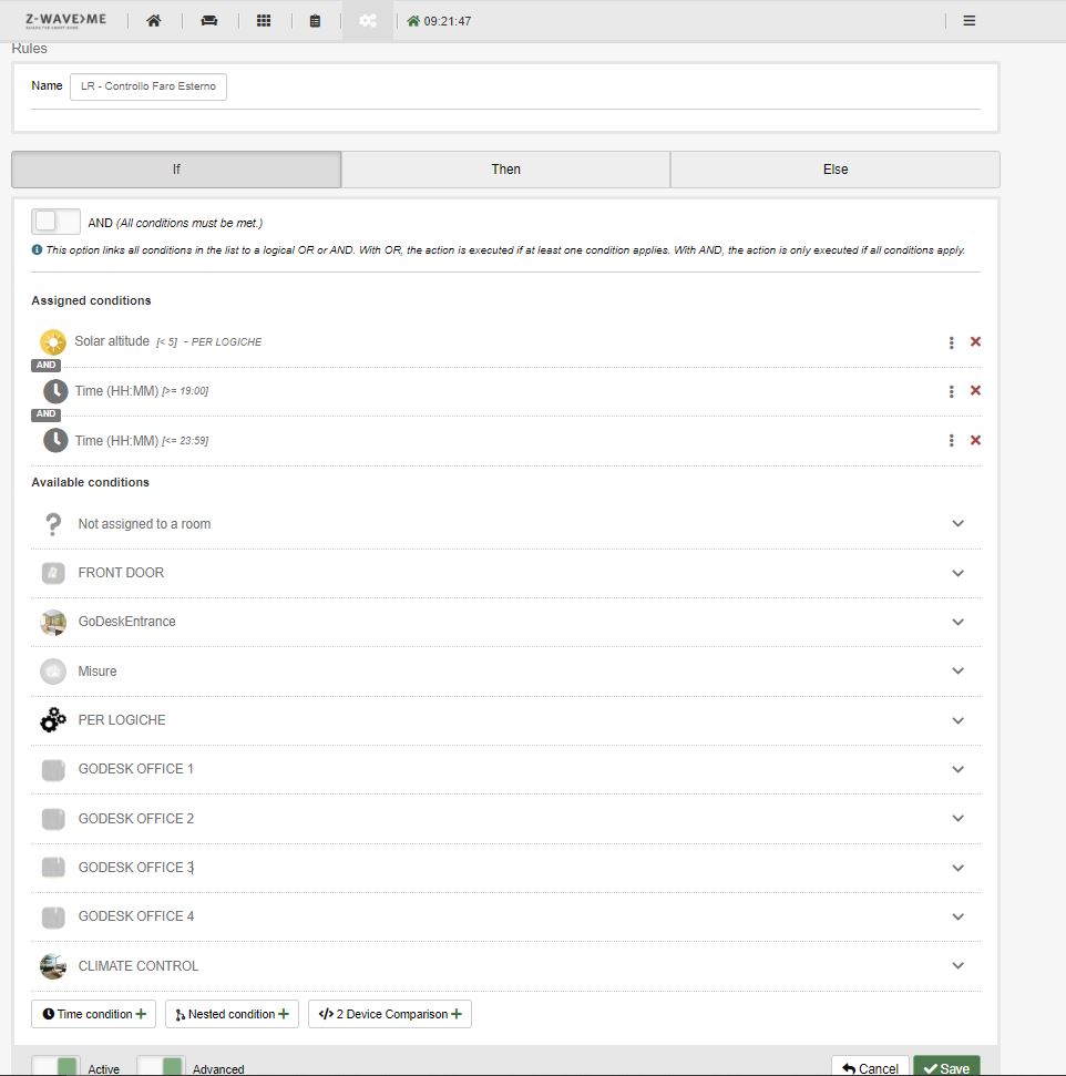

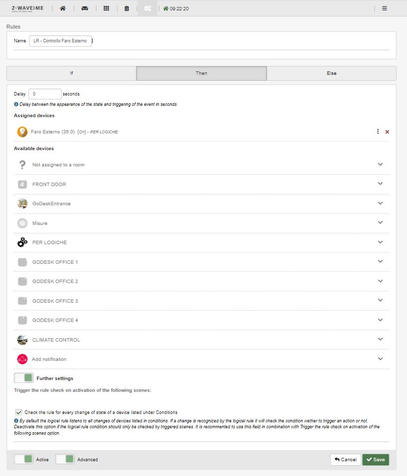

Could you please show your app settings?
Re: Time Concition in Automations
Posted: 03 Nov 2023 11:29
by marco
Hi Poltos,
thanks for your support.
following I report the app configuration that has worked till a few days ago.
Now, to continue use it, I'm forced to remove time conditions.
I tested the app also using only time condition (one ore more) and it doesn't work anymore.

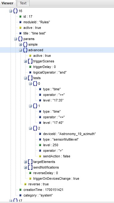

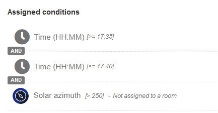

Just tested, this is working for me.
In log I see:
[2023-11-16 17:35:18.959] [I] [core] [Astronomy] Calculate
[2023-11-16 17:35:18.967] [I] [core] HK: updated Astronomy_19_altitude
[2023-11-16 17:35:18.972] [I] [core] Notification: device-info (device-status): {"dev":"Solar altitude","l":"-12.41 °","location":0}
[2023-11-16 17:35:18.983] [I] [core] HK: updated Astronomy_19_azimuth
[2023-11-16 17:35:18.986] [I] [core] Notification: device-info (device-status): {"dev":"Solar azimuth","l":"255.42 °","location":0}
[2023-11-16 17:35:19.058] [I] [core] ---  DummyDevice_16 performCommand processing: {"0":"on"}
[2023-11-16 17:35:19.061] [I] [core] HK: updated DummyDevice_16
[2023-11-16 17:35:19.063] [I] [core] Notification: device-info (device-OnOff): {"dev":"dummy switch","l":"on","location":0}
What is important - that the time condition is only working together with a "device event" - because only the event itself will trigger the rule.
(That's why it was not fired at 17:35:00 - but after altitude device was updated...
Maybe you can check it in log?

4) all automations stored in json file
z-way-server/automation/storage/configjson-xxxxxx.json
-> you could copy it and check the content with a json viewer.
you will see here something like that (in "instances"):
So you could be sure that all is stored right at system.
5) check the Z-Way log for any errors (grep file for "Error") and look for any "suspect" messages - but I think this you have already done....
