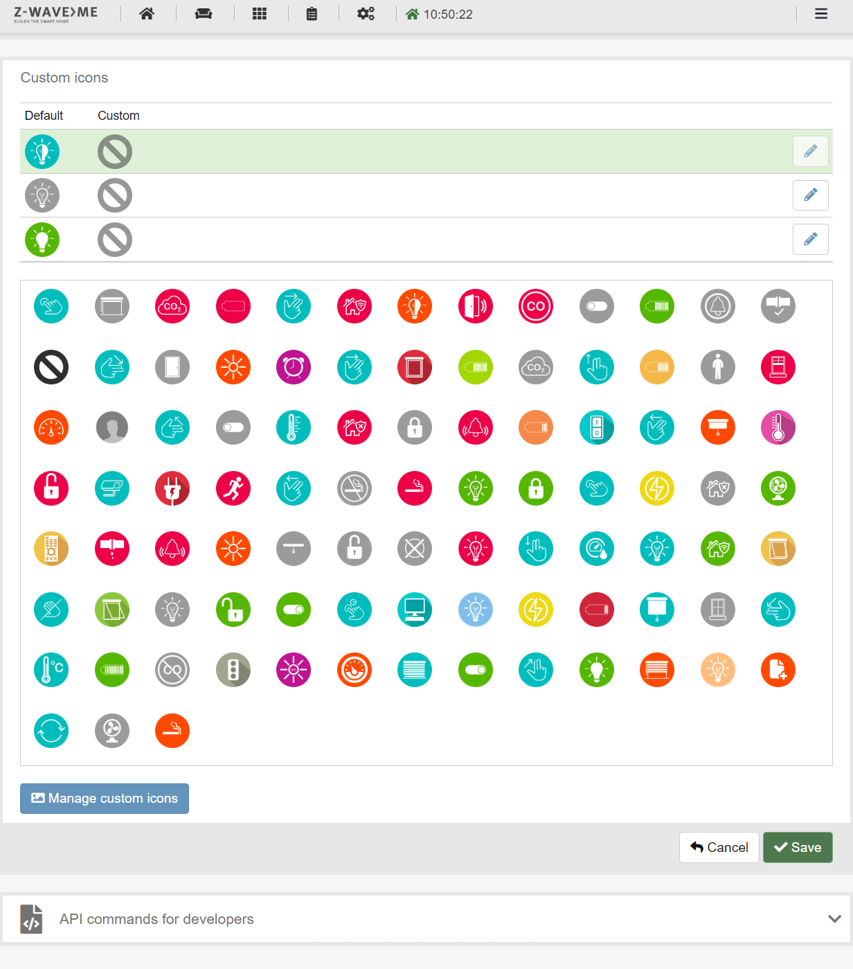

The Z-Way smarthome web UI supports custom icons where a user can change the icons associated with a device. Try selecting the gear icon that appears in the upper-right corner of the device's tile in the smarthome UI and then selecting the pencil icon you want to change. Note that you may need to scroll down to see the Custom icons configuration menu. You should see something like this:
z-way custom icons.png (251.36 KiB) Viewed 33039 times
For whatever reason, the Nice Bidi module reports itself as a multilevel switch (i.e., dimmable light) and not a door lock (see: https://products.z-wavealliance.org/products/3837). You might want to contact the manufacturer to see if they'll update the device's firmware to report the correct device type in the NIF message.
