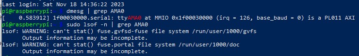

Did some more homeworks:
1. Bluetooth turned off
2. Serial port enabled
It tells me nothing :shock:
BTW:
in file /boot/firmware/config.txt you have inserted the last line?
[all]
dtoverlay=pi3-disable-bt
enable_uart=1
Michael
Re: Z-way installation on Raspberry PI 5
Posted: 19 Nov 2023 00:00
by AlesKO
'/var/log/z-way-server.log' file is empty.
Razberry 7 module works fine on my Raspberry PI 3B. I connected it to Rasp PI 5 before z-way installation.
'/boot/firmware/config.txt' now looks like:
[all]
dtparam=uart0=on
enable_uart=1
There must be some issue with new OS setup.?.
If this helps (http://192.xxx.xx.xx:8083): ERR_CONNECTION_REFUSED
