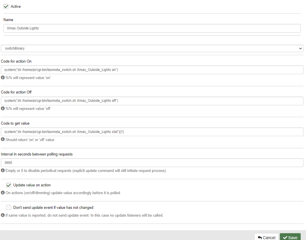

Eureka! Based on the information provided by @aLiEnHeAd, I replaced the HTTP devices with instances of the app called "Virtual Device (JavaScript)". As a result, the z-way-server process on my Raspberry Pi has a CPU load of 4% instead of 12%.
Here's what I did:
1. Added the following line to the file /opt/z-way-server/automation: sh /home/pi/cgi-bin/tasmota_switch.sh
2. Added a file called "tasmota_switch.sh" in directory /home/pi/cgi-bin with the following contents:
#!/usr/bin/bash
ERR_MSG="ERROR - need 2 arguments: LR_Xmas_Tree|Xmas_Outside_Lights|Railing_Xmas_Light on|off|stat"
case $1 in
   LR_Xmas_Tree)
     IP=tasmota-1329.lan
   Xmas_Outside_Lights)
     IP=tasmota-1141.lan
   Railing_Xmas_Light)
     IP=tasmota-7253.lan
     echo "$ERR_MSG"
     exit
esac
case $2 in
   on)
     wget -t 2 -T 5 --connect-timeout=5 -w 2 --no-http-keep-alive --max-redirect=0 -q -O /dev/null "http://$IP/cm?cmnd=Power%20On"
     echo -n "on"
   off)
     wget -t 2 -T 5 --connect-timeout=5 -w 2 --no-http-keep-alive --max-redirect=0 -q -O /dev/null "http://$IP/cm?cmnd=Power%20Off"
     echo -n "off"
   stat)
     if `wget -t 2 -T 5 --connect-timeout=5 -w 2 --no-http-keep-alive --max-redirect=0 -q -O - "http://$IP/cm?cmnd=Power" | grep -q OFF`; then echo -n off; else echo -n on; fi
     echo "$ERR_MSG"
     exit
esac
I used wget instead of curl since wget consumes less resources. I also set various wget command options to limit the amount of time the HTTP GET took and to close the TCP connection.
3. Created 3 devices using the "Virtual Device (JavaScript)" app. Here's a screenshot for 1 of the devices:
Virtual Device (JavaScript).png (47.07 KiB) Viewed 96462 times
4. Deleted the corresponding HTTP device.
In addition to binary switches, I created a similar shell script for multilevel sensors and multilevel switches. Does anyone sees a downside to this approach?
