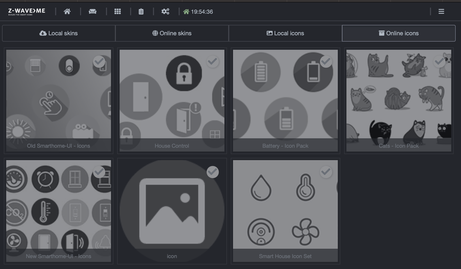

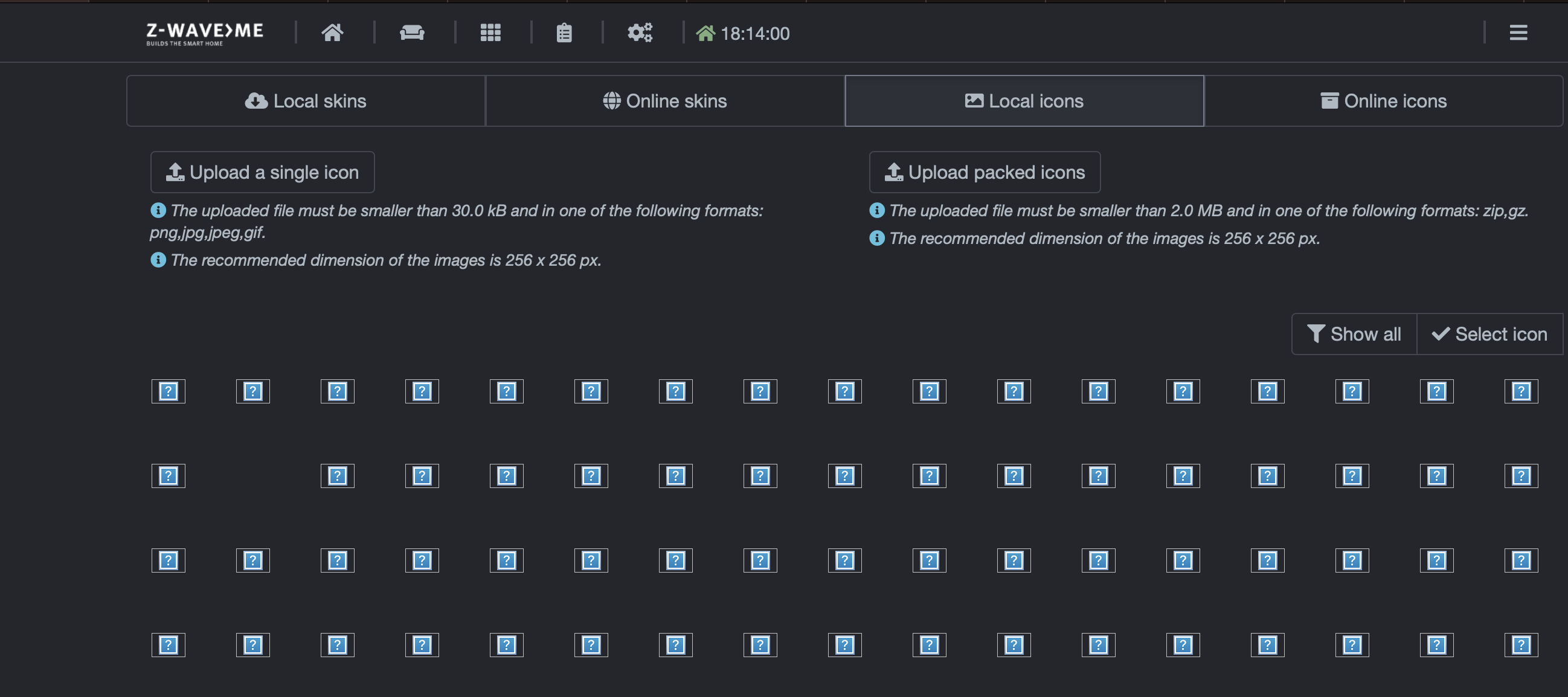

  • First I lost all my downloaded icons and I found no way to refresh the icons. The system insists that all icons are installed properly.

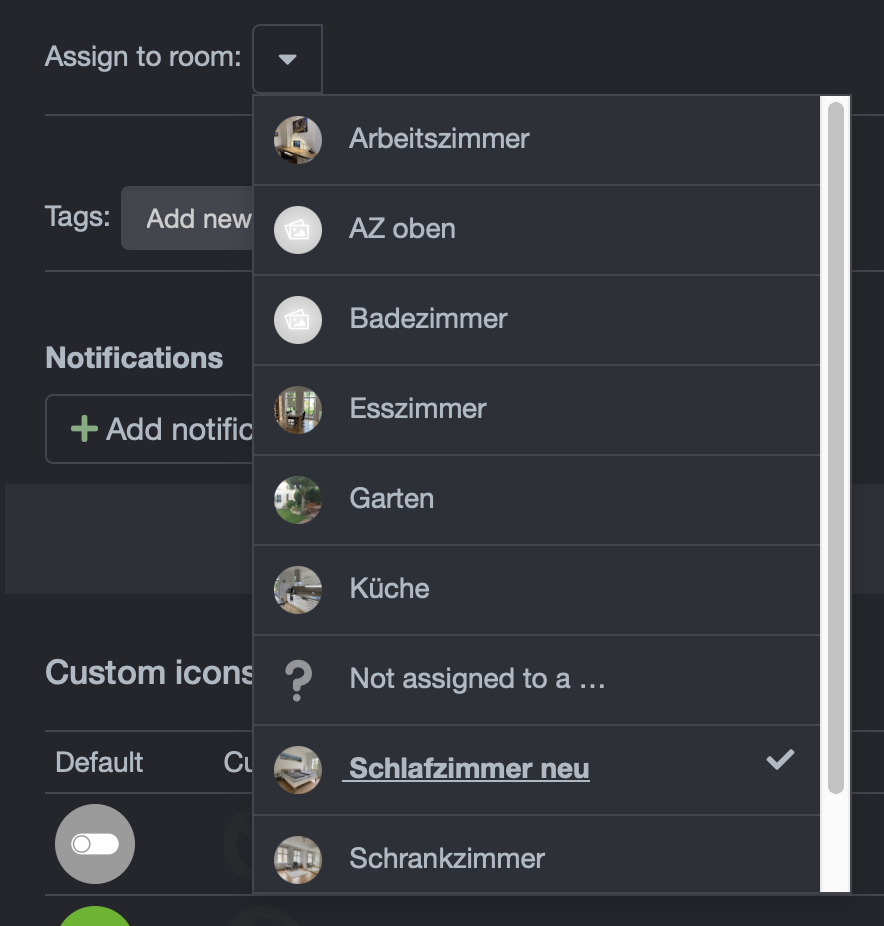

  • Than I got a problem with the rooms: Some exisisting rooms are no longer available in the selection fields for the active devices. Sometimes a selected room is replaced by a different one or none without any interaction.
Bildschirmfoto 2024-01-25 um 18.14.01.png (199.9 KiB) Viewed 11213 times
Bildschirmfoto 2024-01-25 um 18.24.17.png (137.29 KiB) Viewed 11213 times

The missing customs icons are annoying but not a real problem (I just stopped using them). However it is not possible to delete them because there is no option to remove. (see screenshot at the bottom)

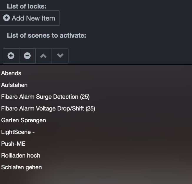

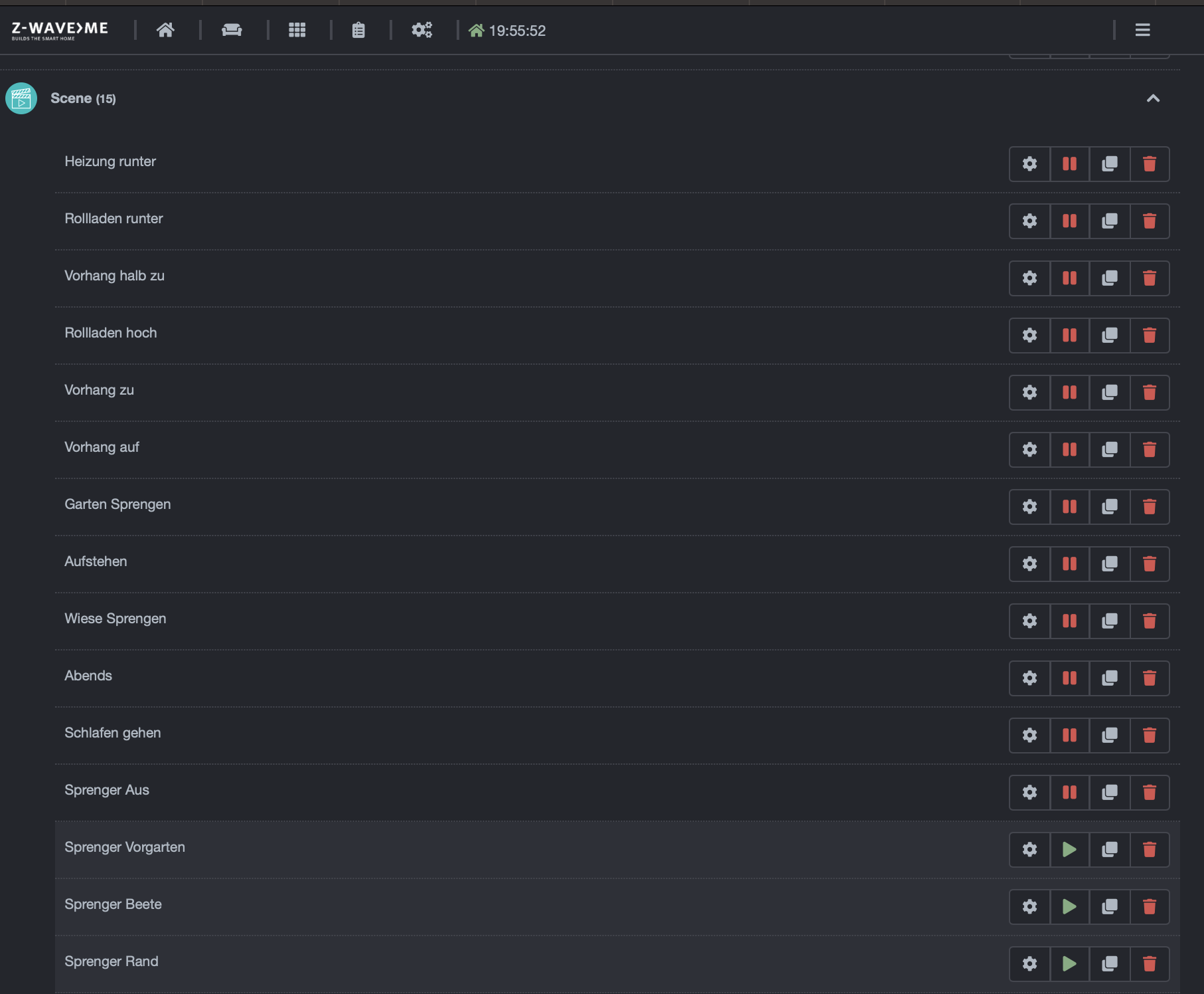

The real issues are the corrupted scenes (other apps as well?) and the corrupted list of rooms. The available scenes are no longer the scenes which are available in the selectors of other apps ("list of scenes to activate"). New scenes are no longer added to these lists. Please have a look on the list of the created scenes:
available scenes.png (187.63 KiB) Viewed 10991 times
The drop down field in "list of scenes to activate" presents a different selection (mainly old scenes are shown, newly edited are missing and nonsense scenes are shown:
list of scenes to activate.png (89.43 KiB) Viewed 10991 times

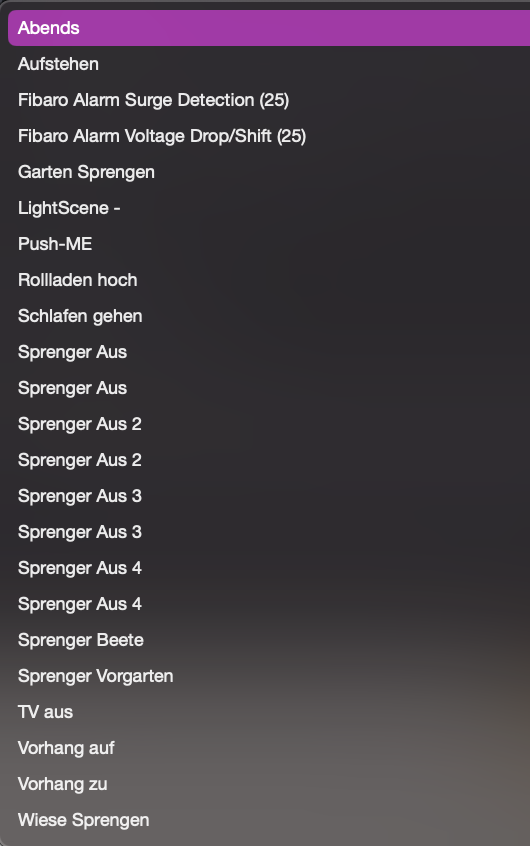

This is the complete list:
List of scenes in drop down.png (111.89 KiB) Viewed 10991 times
