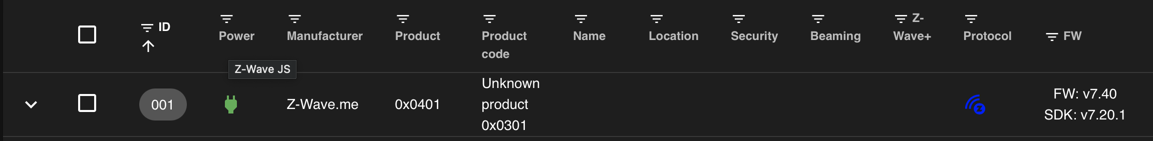

I receive the Z-Station today.
Z-Wave is working fine. With Z-Way Server and Z-Wave JS UI as well.

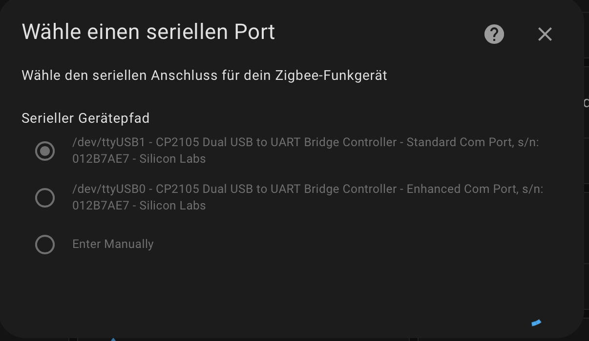

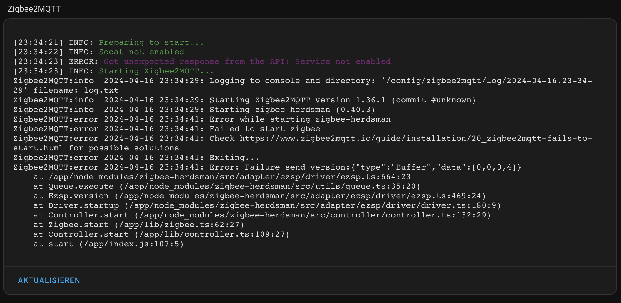

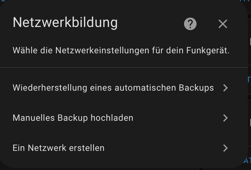

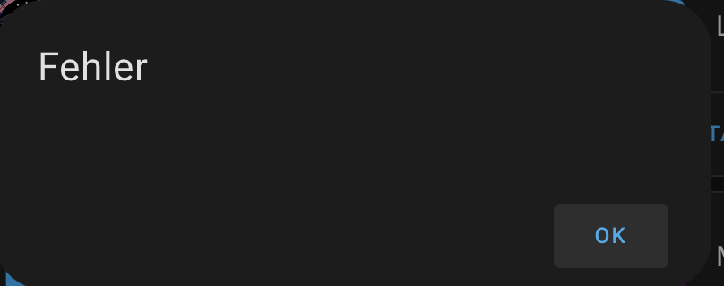

But the Zigbee part I cann't become to work. Not with ZHA, ZigBee2MQTT and also not with the Z-Way Server (ZigBee App)
Z-Wave is running on the serial Port
/dev/serial/by-id/usb-Silicon_Labs_CP2105_Dual_USB_to_UART_Bridge_Controller_012B7AE7-if00-port0
Respectively
/dev/ttyUSB0
Zigbee configuration looks like this:
adapter: ezsp
baudrate: 115200
port: /dev/ttyUSB1
I tried also the port /dev/ttyUSB0
But always the same. Zigbee doesn’t wont to start?!

ZigBee2MQTT:
Bildschirmfoto 2024-04-16 um 23.35.02.png (324.74 KiB) Viewed 18595 times
Any Ideas what is going wrong?
