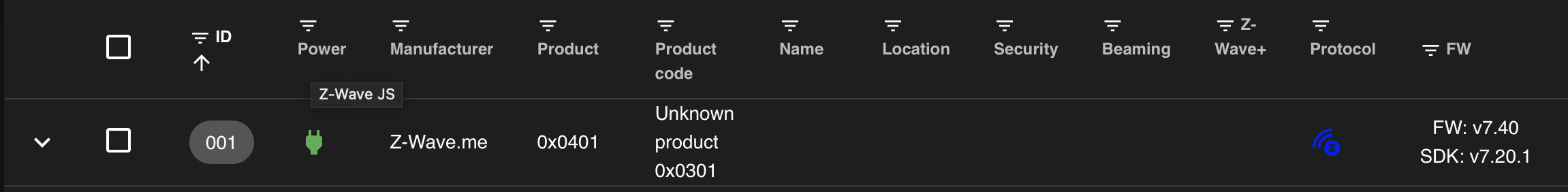

I receive the Z-Station today.
Z-Wave is working fine. With Z-Way Server and Z-Wave JS UI as well.
Bildschirmfoto 2024-04-16 um 23.45.20.png (65.12 KiB) Viewed 18608 times
But the Zigbee part I cann't become to work. Not with ZHA, ZigBee2MQTT and also not with the Z-Way Server (ZigBee App)
Z-Wave is running on the serial Port

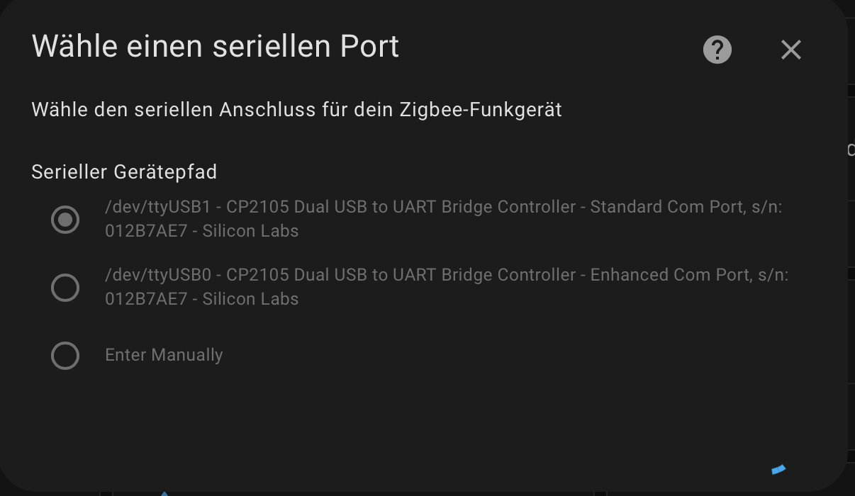

Zigbee configuration looks like this:
adapter: ezsp
baudrate: 115200
port: /dev/ttyUSB1
I tried also the port /dev/ttyUSB0
But always the same. Zigbee doesn’t wont to start?!

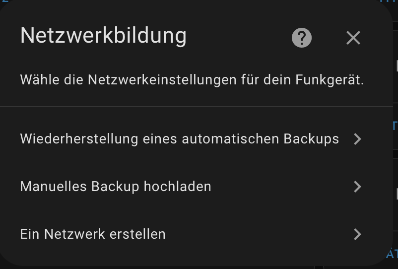

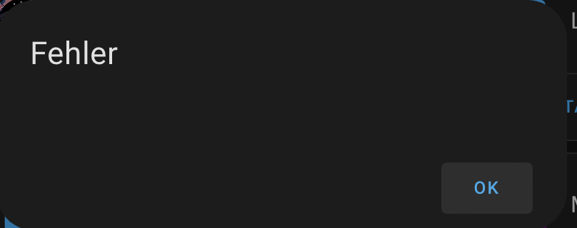

ZHA:
Bildschirmfoto 2024-04-16 um 23.32.07.png (83.45 KiB) Viewed 18608 times
Bildschirmfoto 2024-04-16 um 23.32.39.png (50.16 KiB) Viewed 18608 times
Bildschirmfoto 2024-04-16 um 23.33.10.png (16.32 KiB) Viewed 18608 times

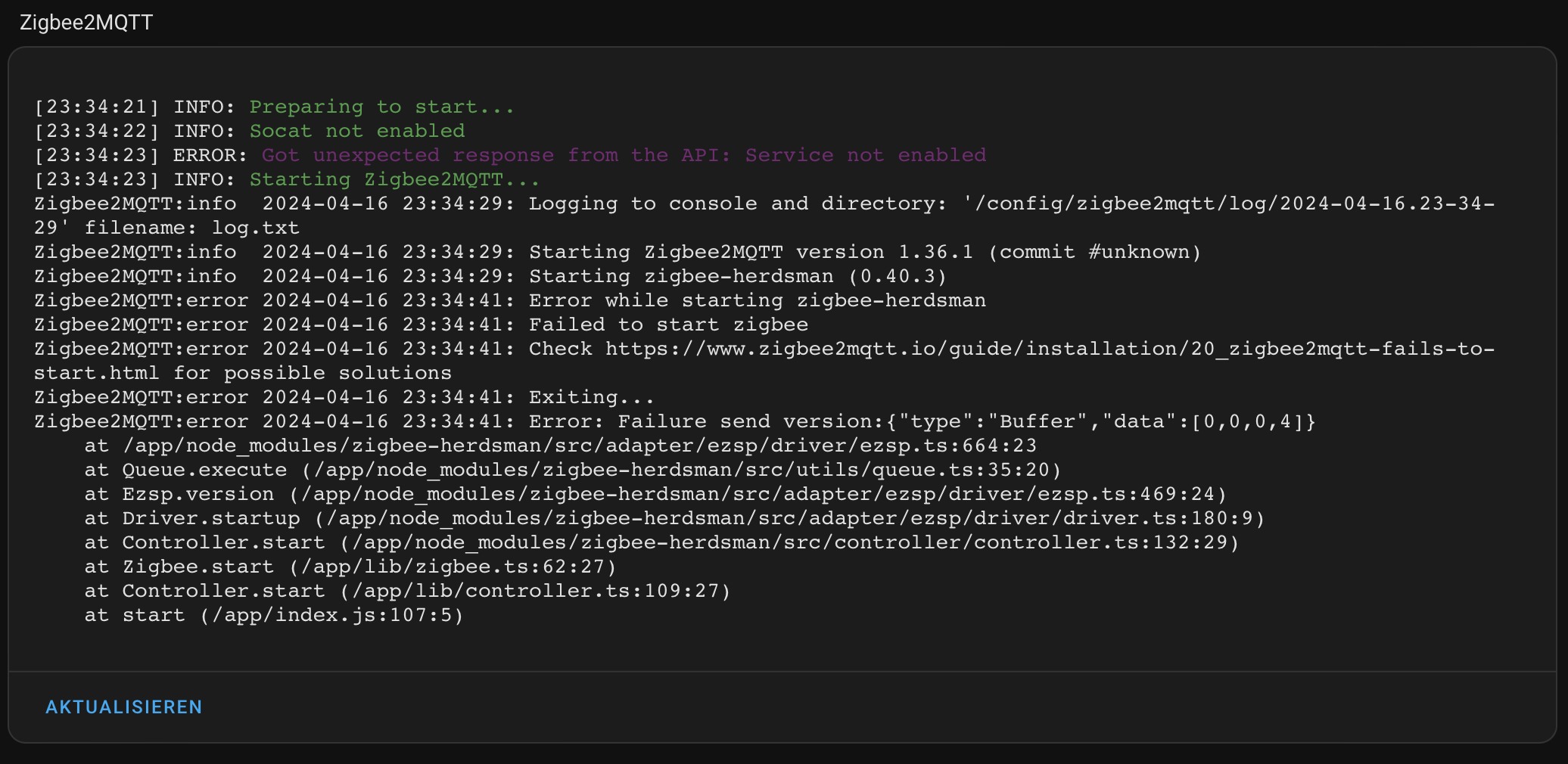

ZigBee2MQTT:
Bildschirmfoto 2024-04-16 um 23.35.02.png (324.74 KiB) Viewed 18608 times
Any Ideas what is going wrong?
