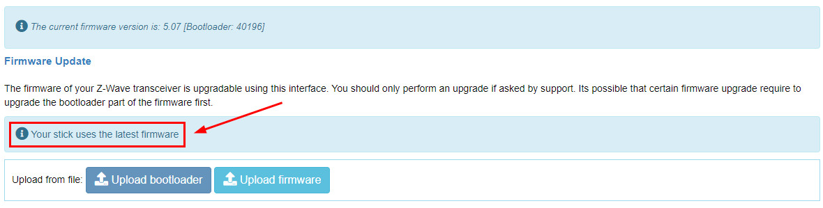

So I was able to use Z-Wave from my Home Assistant Addon to get my UZB up to 5.07 from 5.04, but that’s it (below). I'm looking to get the SDK up to at least 6.61 to take adavatage of the NVM backup/restore functionality.
Is this truly the latest firmware for the UZB or can I manually update to at latest based on what’s available here?

What happens if you use the token of all

Yep, that worked. I was able to see all firmware and updated sucessfully. Thanks!
