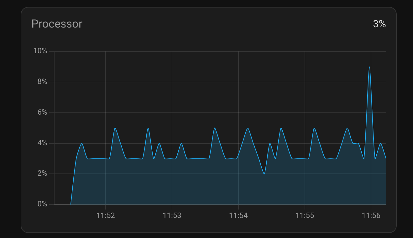

Re: switch from z-wave js ui to z-wave.me?
That is what my CM4 systems look like. They have 8Gb of RAM.

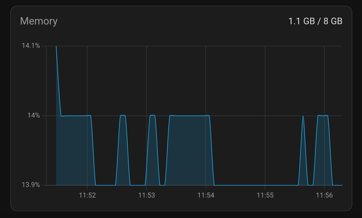

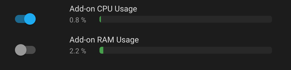

For the core system it is also a CM4 with 8GB of RAM. As you can see, not much for CPU or RAM usage there as well.
- Screen Shot 2024-06-17 at 11.56.22 AM.png (102.79 KiB) Viewed 20016 times
- Screen Shot 2024-06-17 at 11.56.14 AM.png (101.74 KiB) Viewed 20016 times
