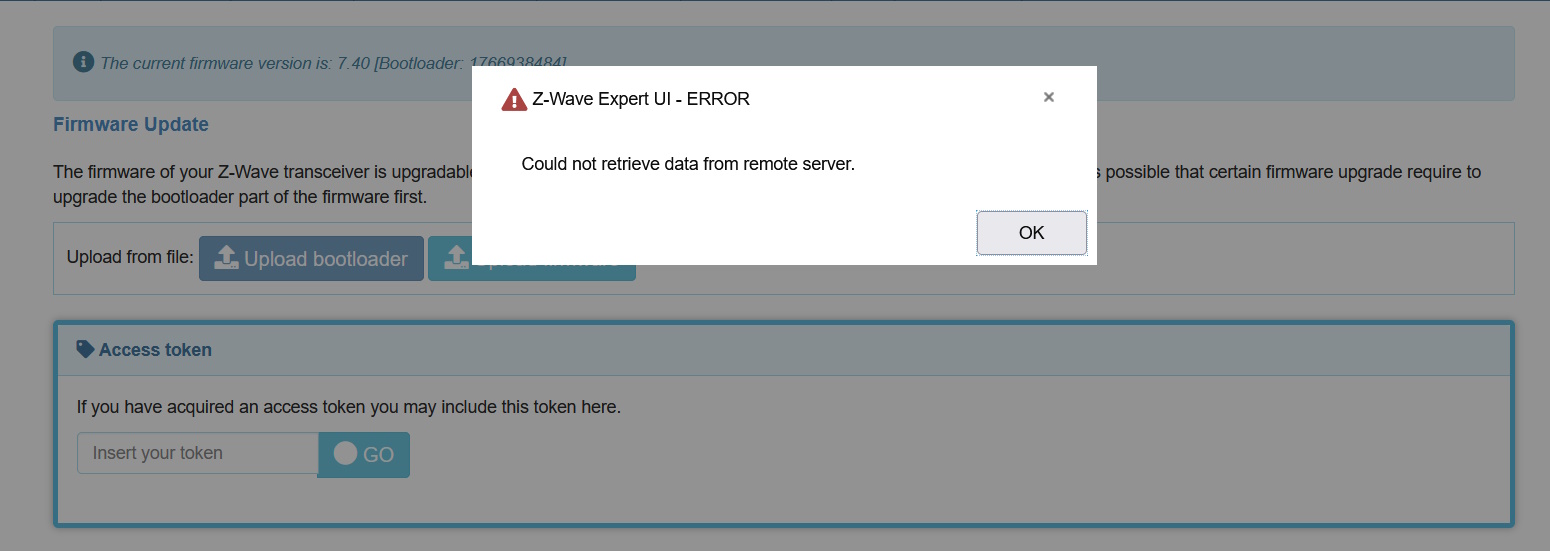

OK, how can i get the update? If i try i get this:
lanbrown
Posts: 385
Joined: 01 Jun 2021 08:06
Re: Trigger SerialAPI Soft reset
Post by lanbrown »
Check the other thread topic that was right below or above your thread:
https://forum.z-wave.me/viewtopic.php?f=3419&t=36079
The upgrade was fixed. Please retry
