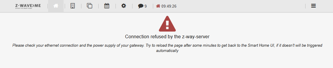

This happens for all 13 thermostats I manage and seems to cause a temporary failure in server communication with UI

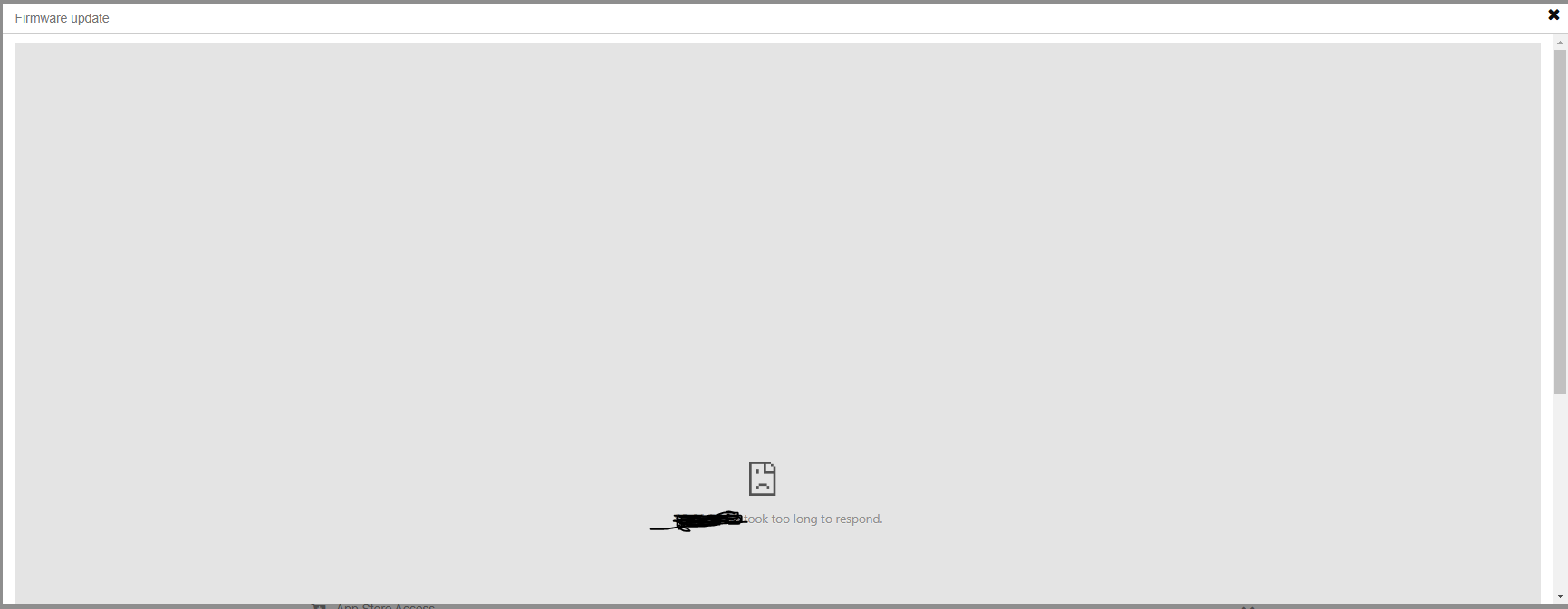

At the moment I cannot update because the updater is unable to load the Firmware Update page
and I would prefer to be on site which is where I'm not.

Please update Z-Way to the newest version (4.1.4) and see if that fixes the problem. The version you are using (3.0.4) is almost 4 years old.
You can update Z-Way remotely from the command line. Run:
PKG=z-way-4.1.4_armhf.deb && wget -O /tmp/$PKG https://storage.z-wave.me/z-way-server/$PKG && sudo dpkg -i /tmp/$PKG
