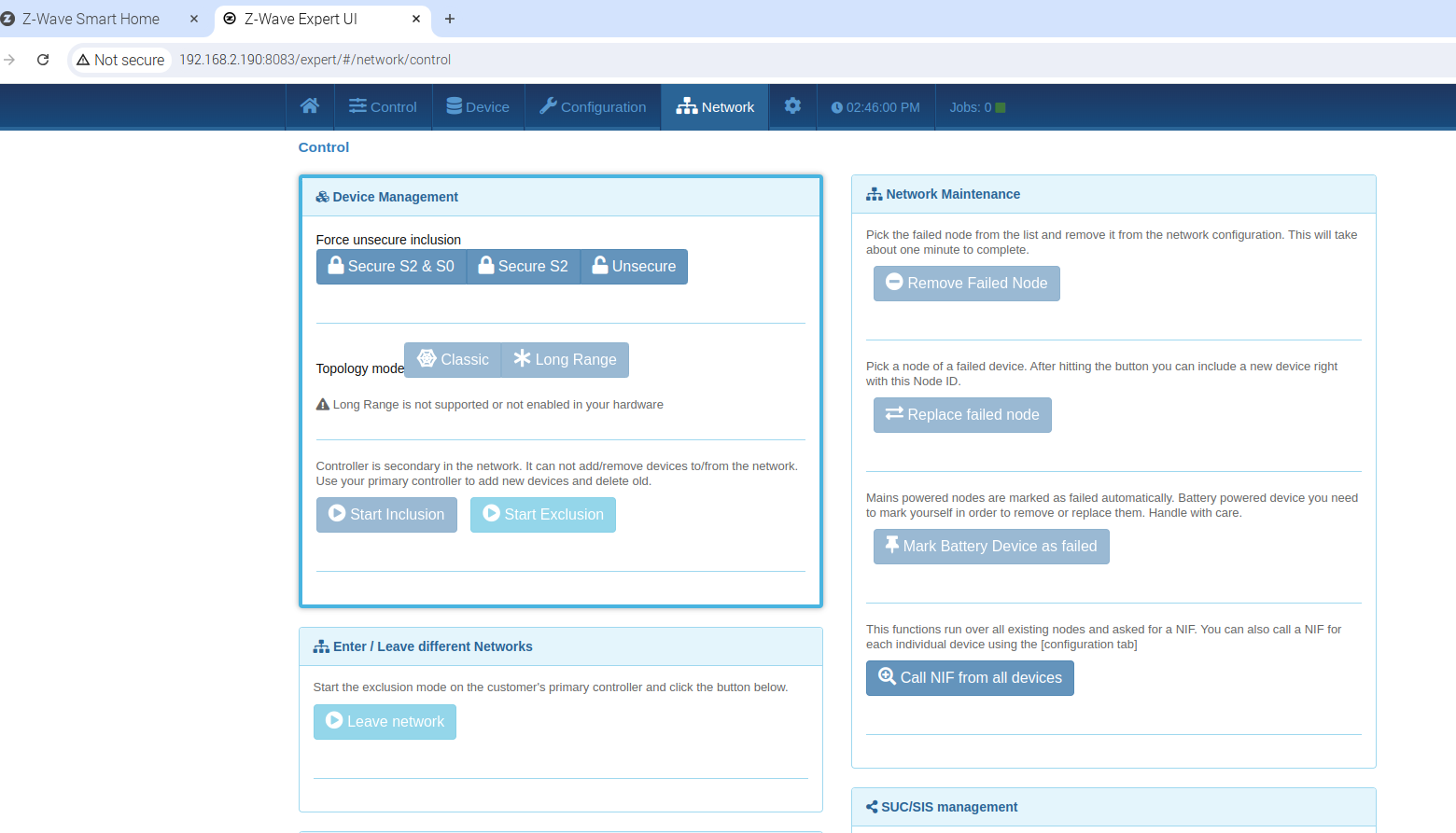

After setting up the system once again from scratch with a new SD Card plus a brand new Razberry board after installing the ZWAY software V4.1.4 in expert view in Control menu there is again the note that the controller is a secondary controller and no devices can be added to the network.
How can it be that the controller "thinks" to be secondary controller when everything is new, the SD Card, the OS, the ZWAY SW and the Razberry HW.

Posted: 07 Feb 2025 20:11
by seattleneil
Based on your troubleshooting, it looks like communication to your RazBerry card (over the serial port) is not working correctly and the expert UI is not showing you accurate information. As a result, you may be chasing a red herring.
The /var/log/z-way-server.log file will show if there's a problem with serial port communications. The log file can be a bit cryptic, just look for SENDING: and RECEIVED: lines and check for good communication.
Assuming you find a serial communications problem, the next step is to fix the problem. Follow the steps in this post:
https://forum.z-wave.me/viewtopic.php?f=3422&t=36043&p=99574&hilit=getty#p99574
As for resetting you RazBerry card, if serial communications are working and the z-way-server process is running, you can bypass the expert UI and do a soft reset by running this command:
curl -u admin:[PASSWORD] --globoff 'http://127.0.0.1:8083/ZWave.zway/Run/SerialAPISoftReset()'
To do a factory reset (dangerous - do an expert UI backup first), run this command:
curl -u admin:[PASSWORD] --globoff 'http://127.0.0.1:8083/ZWave.zway/Run/SetDefault()'
The /var/log/z-way-server.log file will show you what occurred when you run these commands. These commands are described here: https://z-wave.me/manual/z-way/Function ... rence.html
Be sure to check the firmware of your RazBerry 7 card and upgrade if needed - you want to see the following for the Controller Info:
Firmware
SDK Version: 7.21.00
Serial API Version: 07.42
