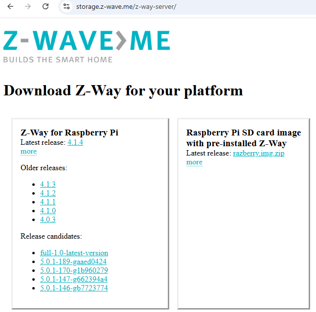

@PoltoS Are you able to put a link to the full 5.0.2 version on https://storage.z-wave.me? Currently, the web site shows the following:
Screenshot 2025-06-08 200659.png (48.5 KiB) Viewed 101311 times

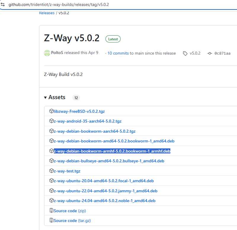

Should Z-Way users running version 4.1.4 on a Raspberry Pi running bookworm download version 5.0.2 from github at this link: https://github.com/tridentiot/z-way-builds (Latest release), as highlighted below?
Screenshot 2025-06-08 204242.png (73.02 KiB) Viewed 101311 times
Is there a changelog for version 5.0.2?
