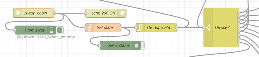

Check out the HTTPGet module in Z-Way. I use it to send device status info to Node-RED (set "URL to get" as: http://10.9.0.1:3002/zway_cabin?device= ... ate=%VALUE%) and am very happy with the simplicity and reliability. On Node-RED, "HTTP In" listens for the GET from Z-Way with other nodes depicted in the attached file.

Thanks for the reply!
http didn't work - I don't know why. I have a few http-get nodes and they are working fine. But this Razberry-crap simply doesn't seem to speak to anything except to its webgui.
I send it all back to Amazon.
