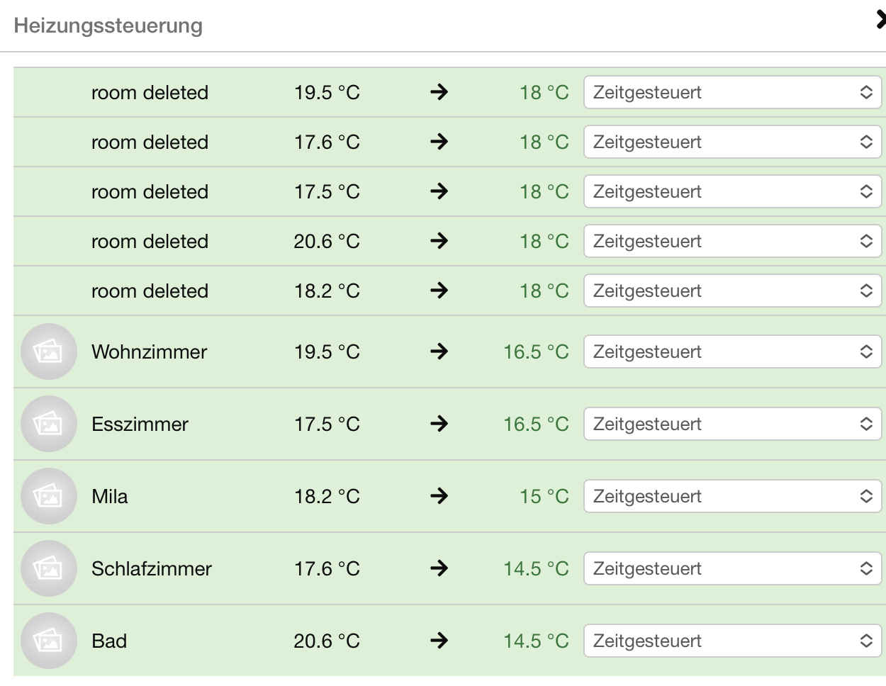

Abend zusammen,
Im Modul Heizungssteuerung werden mir noch gelöschte Räume angezeigt. Wie bekomme ich die gelöscht (ggf. auch über die Konsole, finde aber die Datei leider nicht).

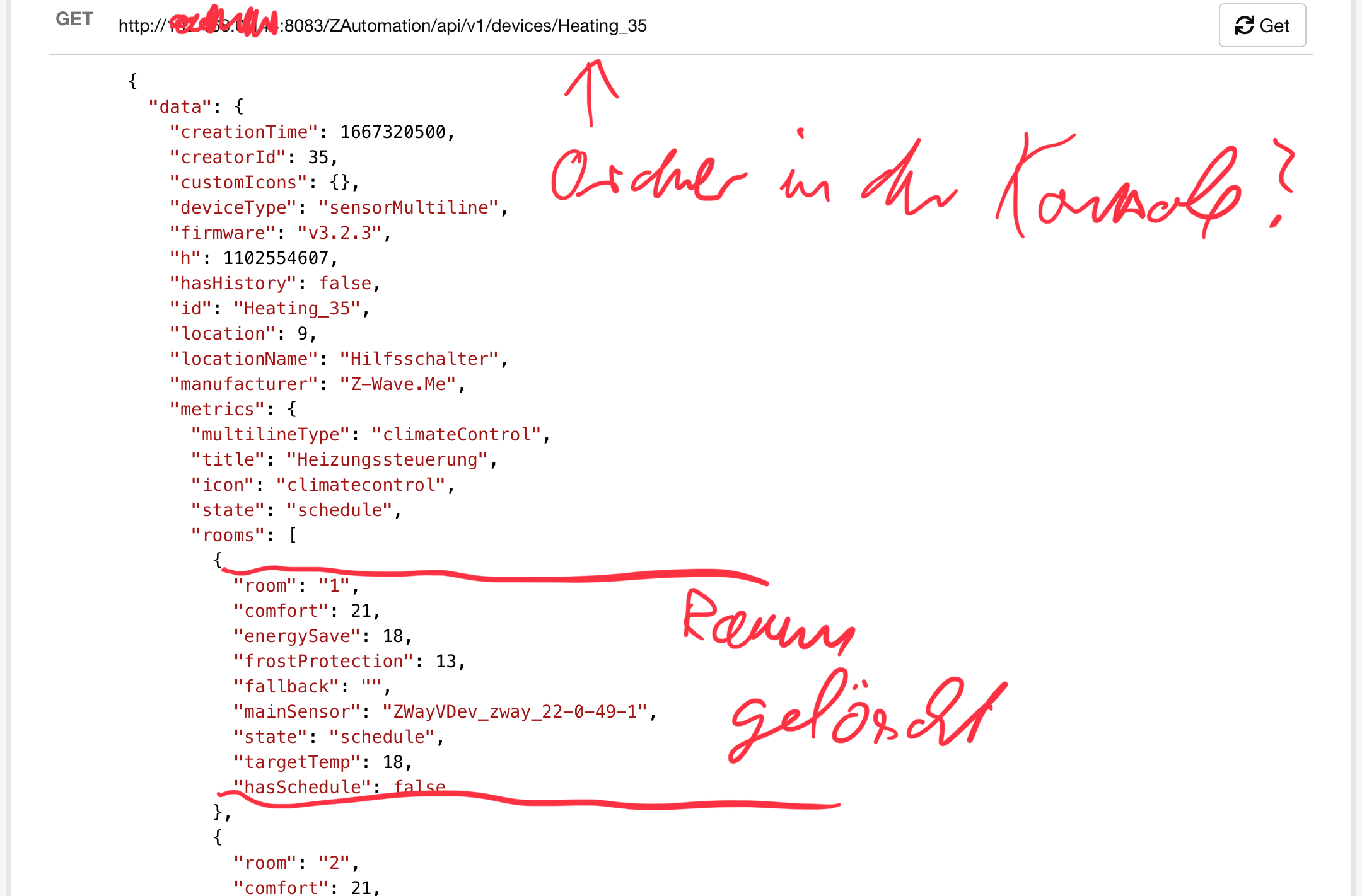

Re: Gelöschte Räume aus Heizungssteuerung entfernen
Posted: 05 Mar 2023 13:45
by jens_s
This is when i call the api of the device (where can i edit the device? i do not find it in files...). Rooms 1-5 do not exist anymore.
{"data":{"creationTime":1667320500,"creatorId":35,"customIcons":{},"deviceType":"sensorMultiline","firmware":"v4.0.2","h":1102554607,"hasHistory":false,"id":"Heating_35","location":9,"locationName":"Hilfsschalter","manufacturer":"Z-Wave.Me","metrics":{"multilineType":"climateControl","title":"Heizungssteuerung","icon":"climatecontrol","state":"schedule","rooms":[{"room":"1","comfort":21,"energySave":18,"frostProtection":13,"fallback":"","mainSensor":"ZWayVDev_zway_22-0-49-1","state":"schedule","targetTemp":18,"hasSchedule":false},{"room":"2","comfort":21,"energySave":18,"fallback":"","mainSensor":"ZWayVDev_zway_31-0-49-1","state":"schedule","targetTemp":18,"hasSchedule":false},{"room":"3","comfort":21,"energySave":18,"fallback":"","mainSensor":"ZWayVDev_zway_24-0-49-1","state":"schedule","targetTemp":18,"hasSchedule":false},{"room":"4","comfort":21,"energySave":18,"fallback":"","mainSensor":"ZWayVDev_zway_23-0-49-1","state":"schedule","targetTemp":18,"hasSchedule":false},{"room":"5","comfort":21,"energySave":18,"fallback":"","mainSensor":"ZWayVDev_zway_33-0-49-1","state":"schedule","targetTemp":18,"hasSchedule":false},{"room":"16","comfort":20.5,"energySave":18,"frostProtection":10,"mainSensor":"ZWayVDev_zway_22-0-49-1","state":"schedule","targetTemp":20.5,"hasSchedule":true},{"room":"17","comfort":20.5,"energySave":17.5,"frostProtection":10,"mainSensor":"ZWayVDev_zway_24-0-49-1","state":"schedule","targetTemp":17.5,"hasSchedule":true},{"room":"18","comfort":20,"energySave":16,"frostProtection":10,"mainSensor":"ZWayVDev_zway_33-0-49-1","state":"schedule","targetTemp":16,"hasSchedule":true},{"room":"19","comfort":17,"energySave":15.5,"frostProtection":10,"mainSensor":"ZWayVDev_zway_31-0-49-1","state":"schedule","targetTemp":15.5,"hasSchedule":true},{"room":"20","comfort":23.5,"energySave":14.5,"frostProtection":10,"mainSensor":"ZWayVDev_zway_23-0-49-1","state":"schedule","targetTemp":14.5,"hasSchedule":true}]},"order":{"rooms":0,"elements":0,"dashboard":0,"room":12},"permanently_hidden":false,"probeType":"","product":"Virtual device","tags":[],"technology":"Virtual","visibility":true,"updateTime":1678009065},"code":200,"message":"200 OK","error":null}
