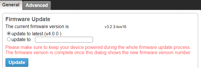

Firmware Update 4.0.0
Posted: 02 Nov 2022 18:43
by feuersee
Screenshot 2022-11-02 164148.png (21.37 KiB) Viewed 29080 times
updater shows me 4.0.0 (current version is v3.2.3-lws16). If i try to update the progress bar is shown but nothing happens.
Greetings Stephan
Re: Firmware Update 4.0.0
Posted: 02 Nov 2022 20:15
by kosinus33
bei mir erscheint die Meldung: Err(1.18.3): main.c: 498: The spawned process 'shell:/bin/systemctl stop netif.$IFACE' has exited with code 5 and says: The seems to run. The version is the same 3.2.3 | Version number: v3.2.3 | UI version: v1.13.5 | Built date: 06-04-2022 02:42:33 | FOR ADMIN ONLY.
Posted: 02 Nov 2022 21:03
by aLiEnHeAd
Liegt möglicherweise daran, dass die Version 4.0.0 noch nicht im repo verfügbar ist:
https://repo.z-wave.me/z-way/raspbian/p ... ay-server/

Aus dem englischen Forum...
Re: V4.0.0
Quote
Post by PoltoS » 05 Nov 2022 15:57
It is available as a .deb package, but has not yet been added to the repository. It will be added next week so you will be able to upgrade.
Posted: 07 Nov 2022 19:23
by kosinus33
Thank you for contacting us with this question, yes, we are aware of this problem and we will fix it soon, but you can solve the problem yourself and connect via SSH faster and run the command:
cd /tmp && wget https://storage.z-wave.me/z-way-server/ ... _armhf.deb && sudo dpkg -i z-way-4.0.0-lws16_armhf.deb
