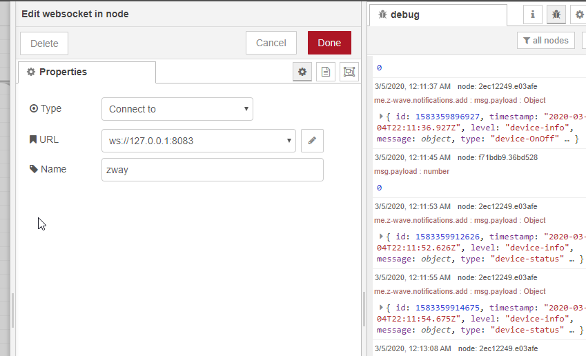

PS: если кому интересно нативное (для node-red без доп модулей) решение получения всех (ну кроме бага выше) евентов в node-red
[{"id":"86e99929.3d4108","type":"websocket in","z":"179573b4.5b21bc","name":"zway","server":"","client":"4993b7b2.e2ce48","x":110,"y":260,"wires":[["a48bae2d.b25e6"]]},{"id":"2ec12249.e03afe","type":"debug","z":"179573b4.5b21bc","name":"","active":true,"tosidebar":true,"console":false,"tostatus":false,"complete":"payload","targetType":"msg","x":750,"y":260,"wires":[]},{"id":"a48bae2d.b25e6","type":"json","z":"179573b4.5b21bc","name":"","property":"payload","action":"","pretty":false,"x":250,"y":260,"wires":[["602bbfb9.5019c"]]},{"id":"602bbfb9.5019c","type":"change","z":"179573b4.5b21bc","name":"","rules":[{"t":"set","p":"topic","pt":"msg","to":"payload.type","tot":"msg"},{"t":"set","p":"payload","pt":"msg","to":"payload.data","tot":"msg"}],"action":"","property":"","from":"","to":"","reg":false,"x":420,"y":260,"wires":[["71cfc83e.520388"]]},{"id":"71cfc83e.520388","type":"json","z":"179573b4.5b21bc","name":"","property":"payload","action":"","pretty":false,"x":590,"y":260,"wires":[["2ec12249.e03afe"]]},{"id":"4993b7b2.e2ce48","type":"websocket-client","z":"","path":"ws://127.0.0.1:8083","tls":"","wholemsg":"false"}]
