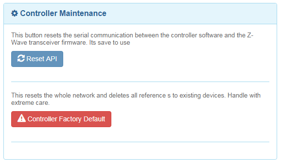

There is an option in Expert Mode - Reset Controller to factory defaults. Did you try it?

Thanks for suggestion! Indeed, I found it as well :) And eventually I reset my new controller this way.
So I assume the reset button does NOT work as intended, and the long press (over 10s) does NOT resets to factory defaults.
Sad, because such statements appeared in a paper documentation submitted with the RaZberry2, so you may start wondering what else there is not true...
