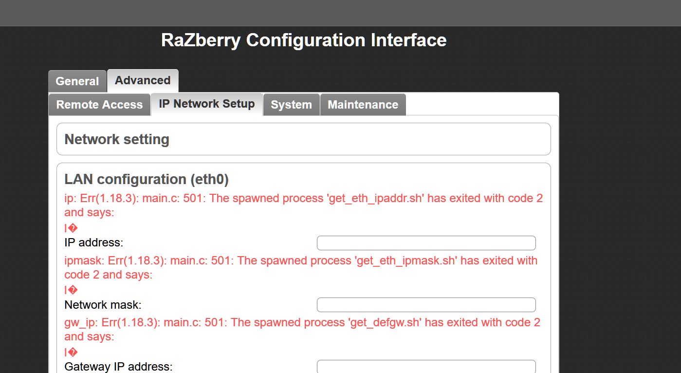

I have a problem, from I upgraded to v2.3.6 since v2.2.5, z-way-server stop randomly (1 day, 2 days, 5 days,...). Into z-way-server.log not inform of nothing when server is stopped. Into log, continualy it view: [core] Can not make request: Couldn't connect to server, but I don't know if this is the problem because the server stopping.
Review Updater UI, into network setting, I view IP, mask and gateway program exception:
Network setting
LAN configuration (eth0)
ip: Err(1.18.3): main.c: 501: The spawned process 'get_eth_ipaddr.sh' has exited with code 2 and says:
l�
IP address:
ipmask: Err(1.18.3): main.c: 501: The spawned process 'get_eth_ipmask.sh' has exited with code 2 and says:
l�
Network mask:
gw_ip: Err(1.18.3): main.c: 501: The spawned process 'get_defgw.sh' has exited with code 2 and says:
l�
Regards,
Diego.
UI Updater exception
error_Firmware_Update_network settings.JPG (111.57 KiB) Viewed 20195 times

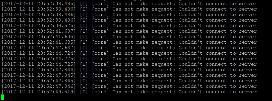

Errors log
Errors log

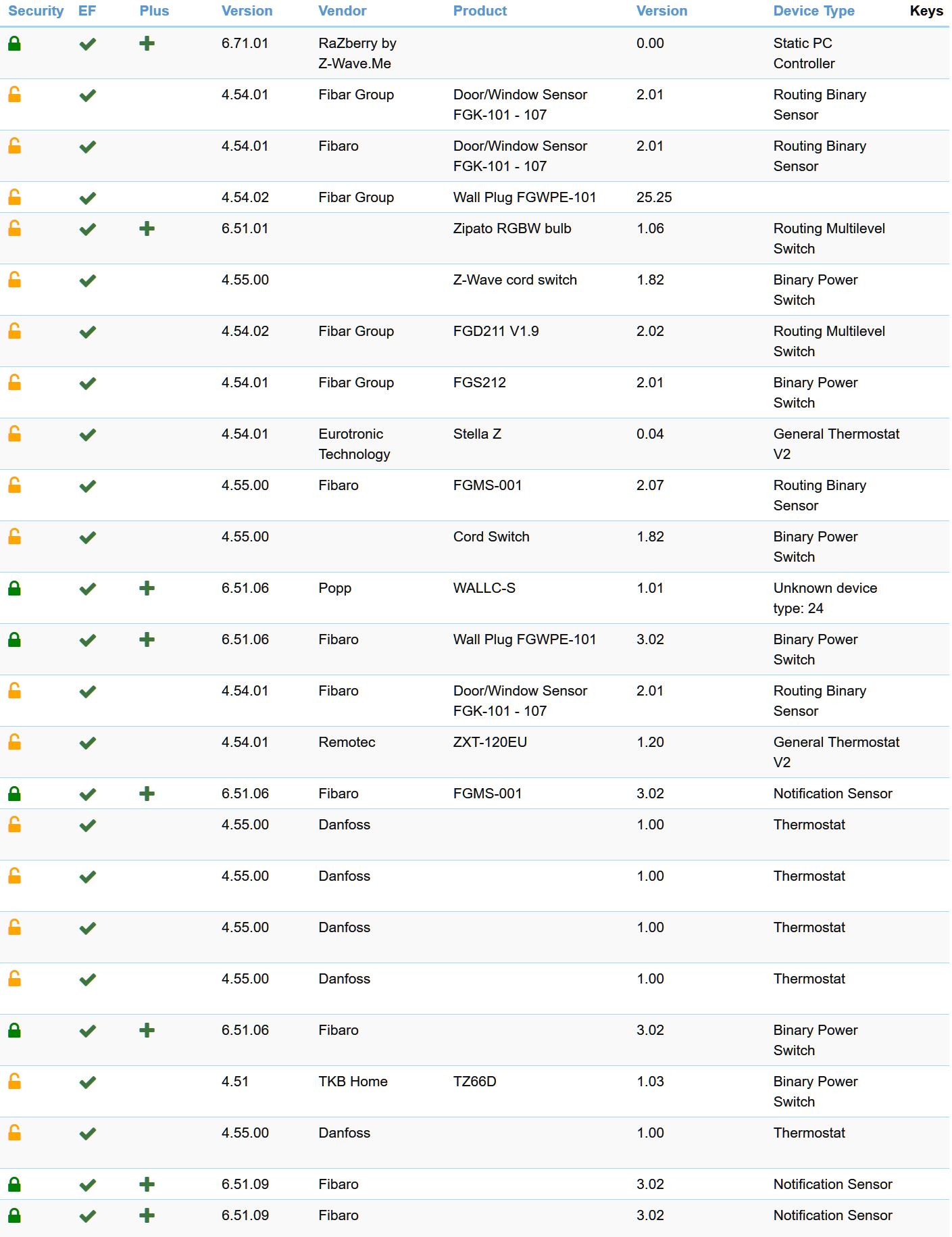

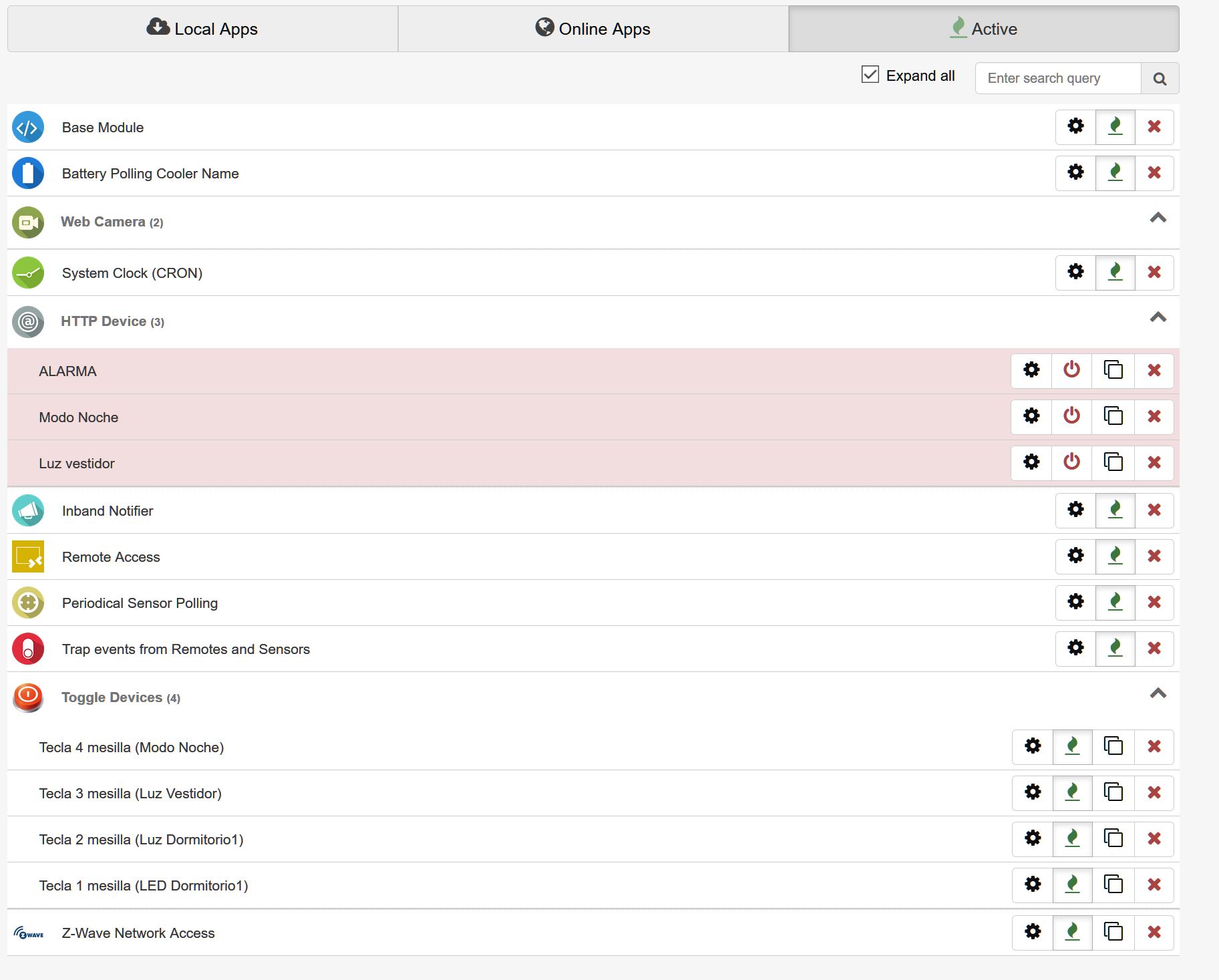

Re: z-way-server stopped randomly v2.3.6 from v2.2.5
What modules do you have running?
If it crashes systematically, please follow this guide to help us understand the cause: viewtopic.php?f=3422&t=25592&p=71226&hi ... ipe#p71176
añep
Posts: 64
Joined: 10 May 2016 13:53
Post by añep »
I attach my intalled modules.
The system crash randomly, 2 days, 4 days, 1 week,....
Appologize, I meant Apps. Got to Smart Home UI -> Settings -> Apps -> Active
I attach my intalled apps. Web Camera is not posible expand and configure.

I am trying to disable Http Devices which not working by change url and it's who was inserting into log, continualy: [core] Can not make request: Couldn't connect to server, and could be the problem because the server stoped. A week without server stoped.

Another week. Is it ok? Can you now start adding back your apps to see what will cause the issue?
