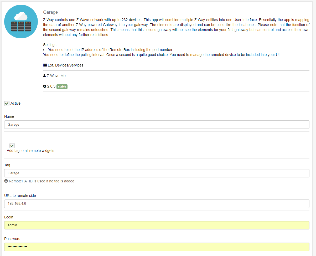

I am using a RPi 3 with RaZberry v2 with the latest firmware and when Im trying to link to another z-way controller(its a controller located in the garage aprox. 100m away and many concrete walls apart) that runs on a earlier RPI with Razberry v1 with latest firmware. That unit connects through VPN to my local network so they reside on the same network(apart from different subnets that are routed to eachother). When I add the app and configure it no devices are imported/visible on my primary Razberry. Im happy to comply to share any information needed to resolve this =)

Adding a screenshot of the configuration of the app.
Screenshot of configuration
