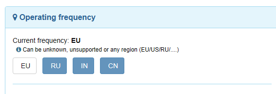

I bought Razberry V2 card from the local seller in Australia and he is insisting that all the boards are for AU frequencies. However, if I go into expert mode I only see EU/IN/RU/CH and no option to set AU/NZ frequency. I have tried the steps in https://forum.z-wave.me/viewtopic.php?f=3422&t=25882
but still the same issue.

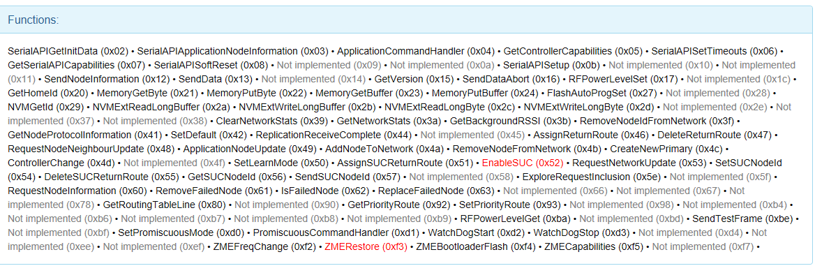

Also why am I having the following ZEMRestore in red in the Controller Info page in expert mode

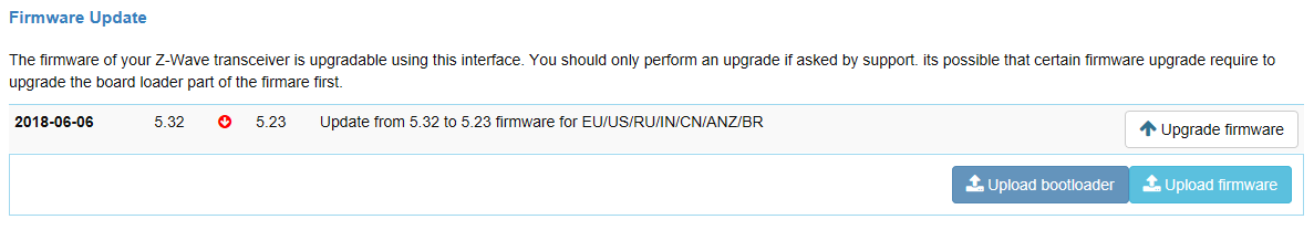

I have updated it to the latest firmware as well.
Any idea how to set the frequency.

Do right in the URL /JS/Run/zway.ZMEFreqChange(4)

Thanks, it worked!
