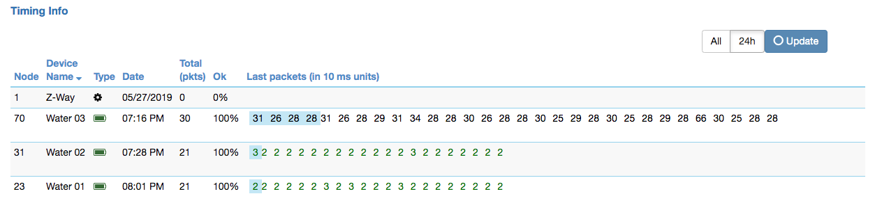

timing info is fantastics. just a few questions to fill the gaps in my understanding.
1- does the time also include the wait time in the job queue?
2- i get the red/gree/black color, it's also set to only 24h. what does the blue background mean?
3- looks like it's only for zway -> device communication, how to get it to also include devices -> zway communication, or not possible?
thank you!
Screen Shot 2019-05-28 at 8.27.44 PM.png (50.83 KiB) Viewed 10212 times

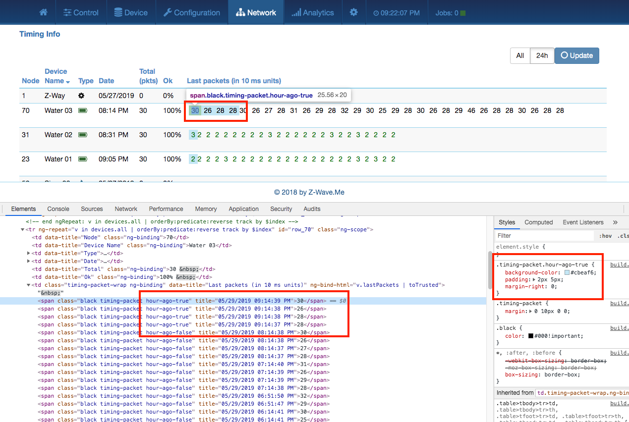

i fired out chrome js debugger and based on what i see, i am concluding the blue highlight means within the hour.
enbemokel
Posts: 499
Joined: 08 Aug 2016 17:36
Re: expert ui / timing info
Post by enbemokel »
Hi, good idea with debugging, thanks for info.
1 no, only real send operation
2 blue is last hour
3 of course no - only the sender knows it. Use route map for this on new 5.37 firmware
