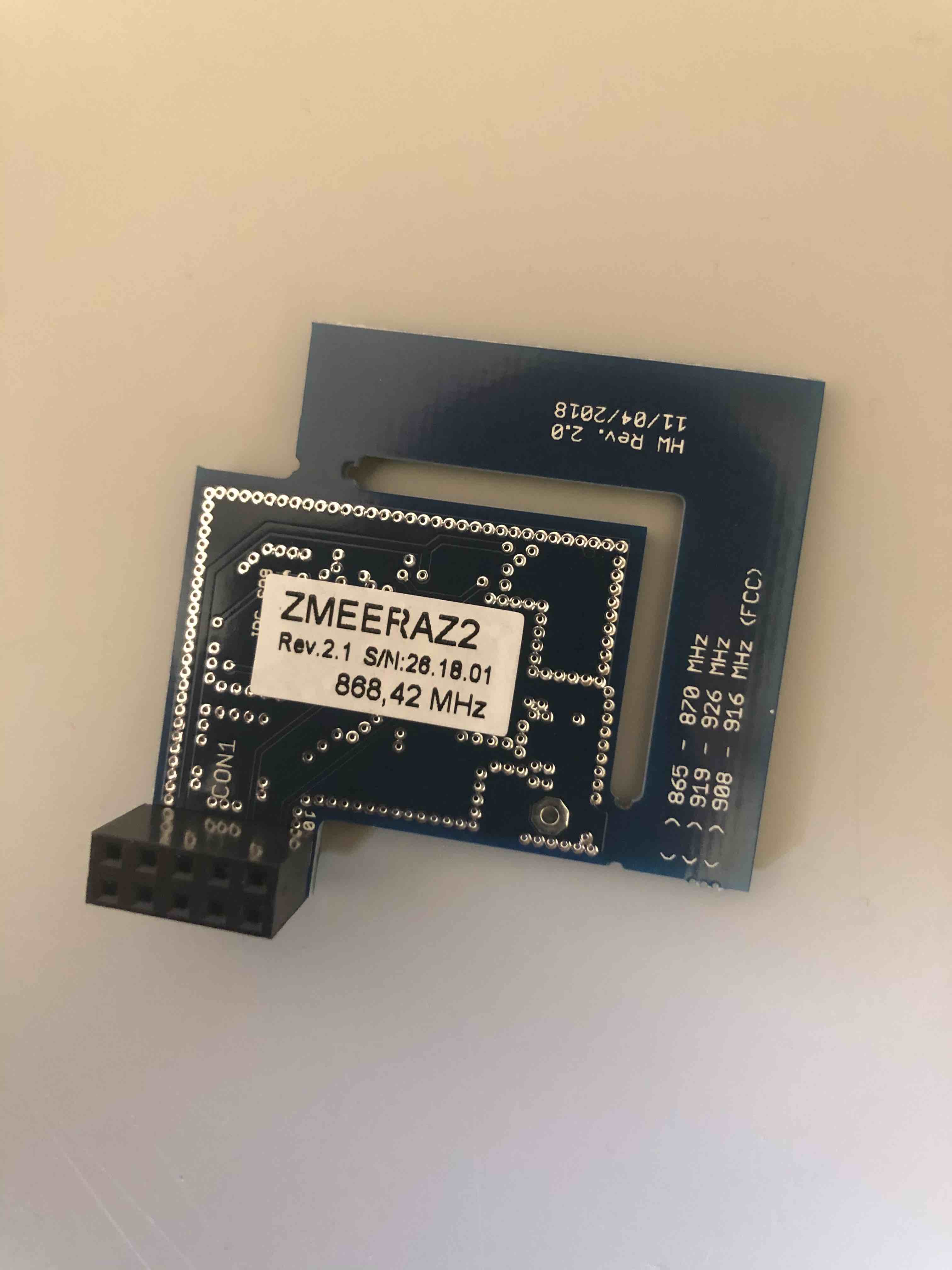

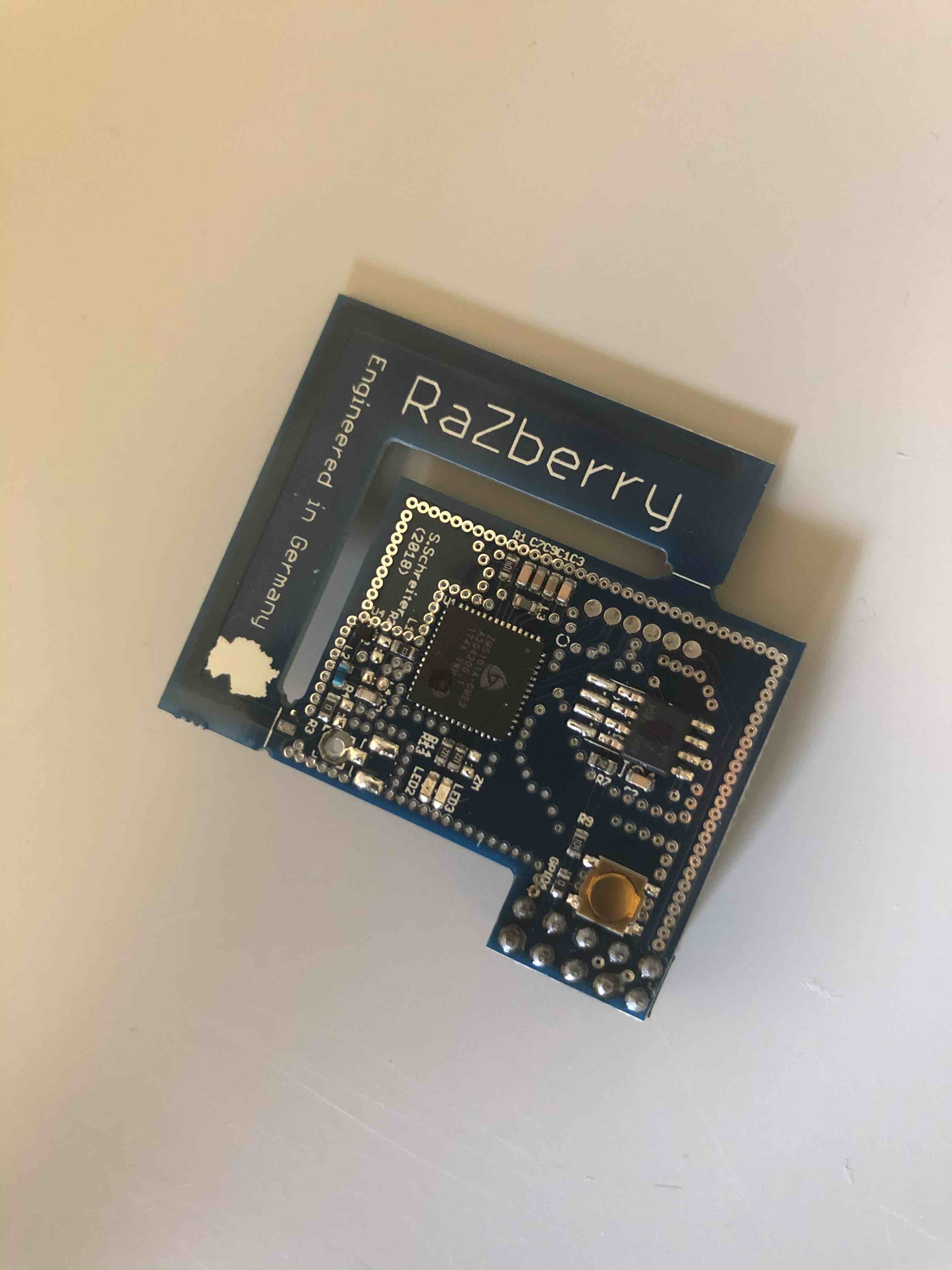

Is there any way to force bootloader and FW upgrade to make it up an running again ?
Board pictures attached.
